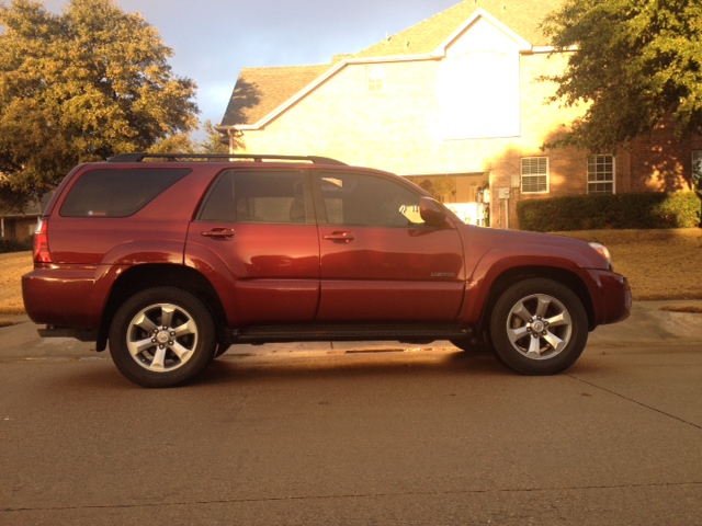

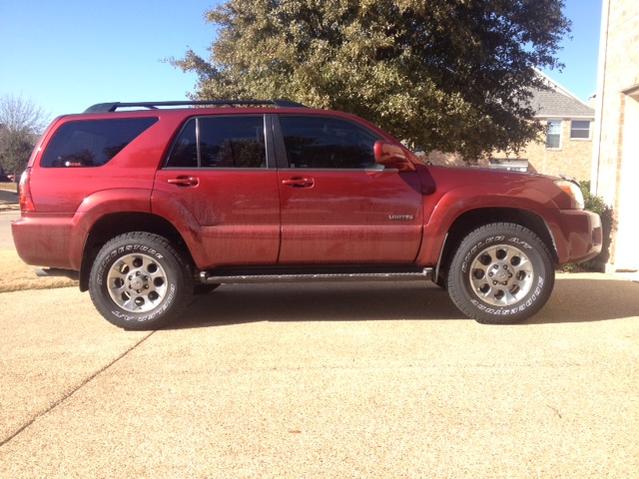

Installed the following today on the front of my truck:
- FJ 4x4 springs (~5000 miles)
- Wheelers Offroad 1/4" poly spacer and poly spring isolator
- Bilstein HD shocks (would have gone 5100, but got these new in box for $50)
Gained 2" in the front after an 8 mile drive -- went from 18.5" to 20.5".
Tomorrow: Rear FJ springs and 5100's. Hoping to get 1/2".
Even without the rears done the ride is drastically improved.
Later this week: FJ 8-hole wheels and 265/70-17 Bridgestone Dueler Revo 2's -- and an alignment.
I'll post pics when it's all done.
Ok, here are some before/after shots (sorry, crappy iPhone pics). Like I mentioned above, I gained exactly 2" in the front and 1/4" in the rear. There is still a slight rake, but I didn't want it to be completely level -- so I'm very pleased with the look and more importantly, the ride.

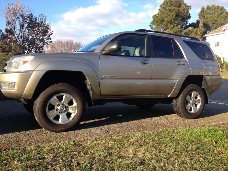

Here's a quick shot of my 04 SR5 sitting on 2007 FJ shocks and springs with Daystar 2.5/1.5 on top.
