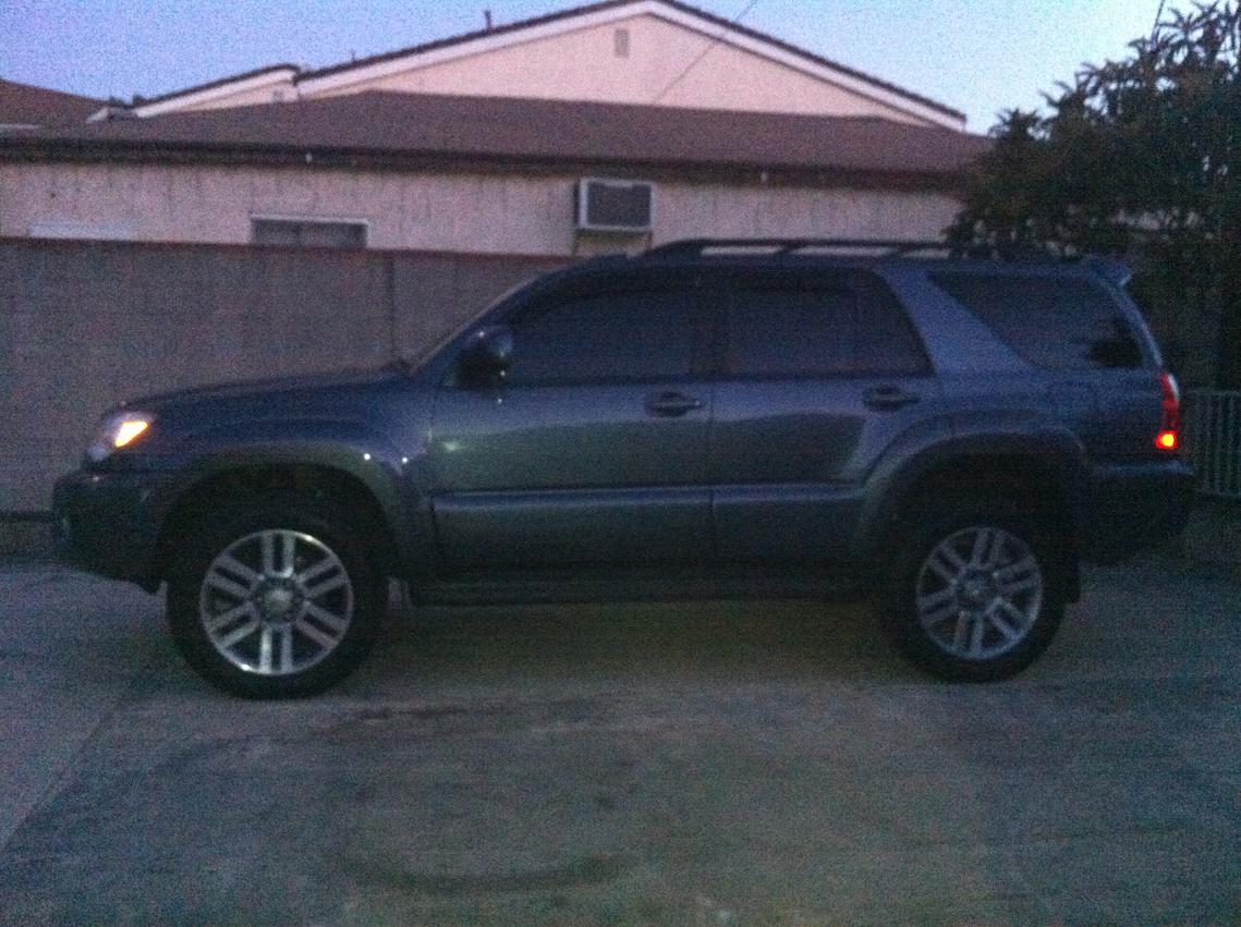

Finally got my 2010 FJ Springs installed. Went with the 1/4" Toyotec spacer up front. I have a 2wd V8. I think it turned out quite nice.

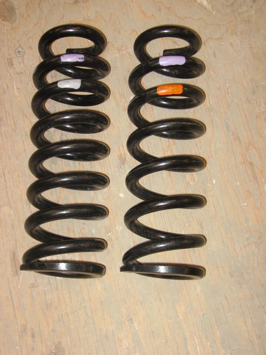

These set of coils are from a 2012 FJ cruiser. Based on the color codes can you tell if they would work in my 2008 4Runner? are they from a 4wd?
I read somewhere to make sure they are from a 4wd to get some lift. I don't know if they are.
I read different posts about the color codes, but I can't tell what color are these. I can't see colors pretty well. Thanks for the help.

I would guess colors would be different for a 2wd, but I don't know what those would be. The 2012 FJ coils should fit though. Those colors are different than mine were, so I'm not sure. You should be able to look at them and tell one is slightly taller than the other, the taller one is the driver side.

I can not tell ya' if from 4wd. However counting coils leads me to believe the one the left is the drivers side.
