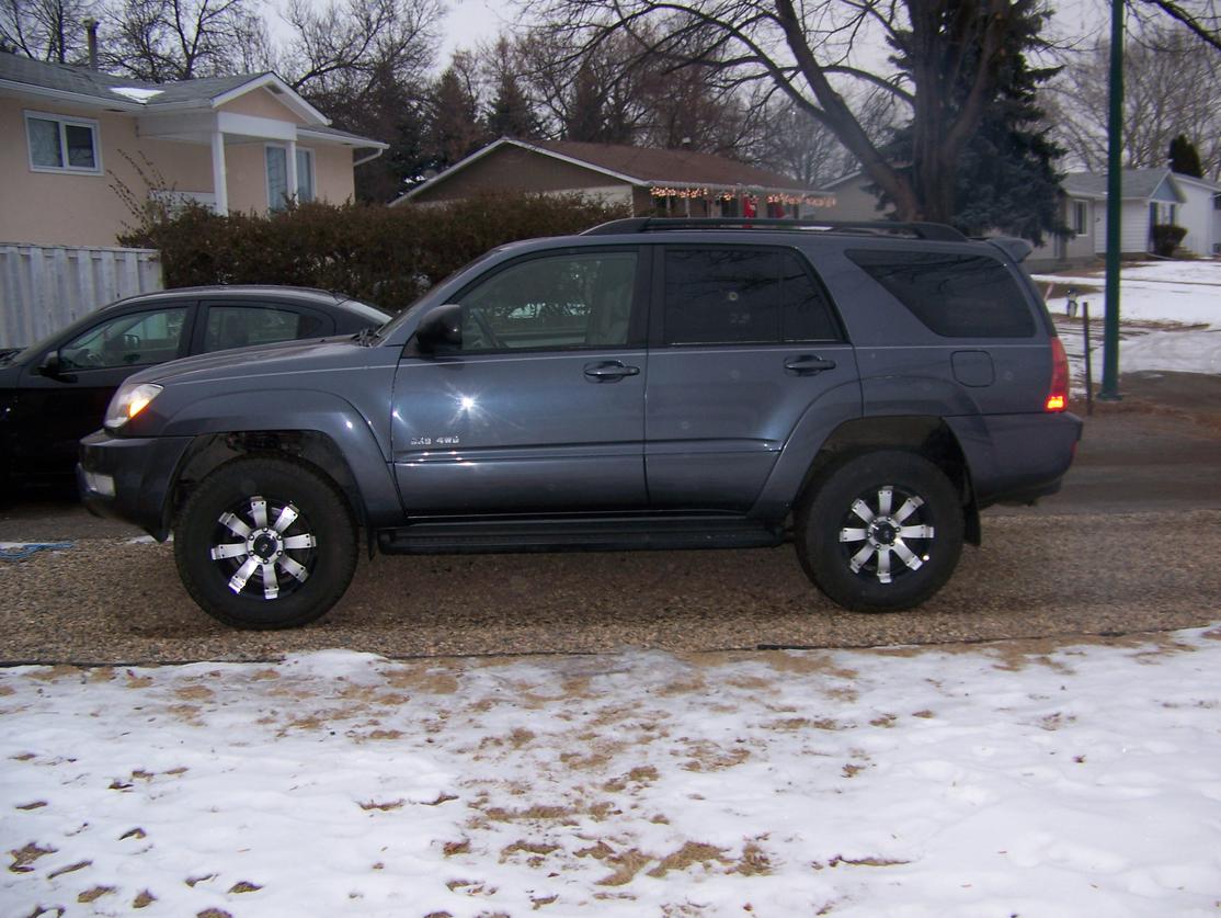

I thought it would be best to get it checked, just needed that reassurance. I'll get some pictures today when the wife brings it home.
Well after driving it around for the day and letting things settle in, it appears that I gained about 1/4" in the rear and lost about 3/4" in the front from the setup I had before. I should have picked up the 1/2" spacer instead, **** happens, its not the end of the world.
