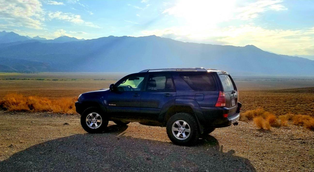

2012 FJ springs, 5100's, 1" Cornfed spacers out back and front struts set to 1.75" of lift. Love the height and how she rides. Took about 3 weeks to break in. Now a much smoother ride.

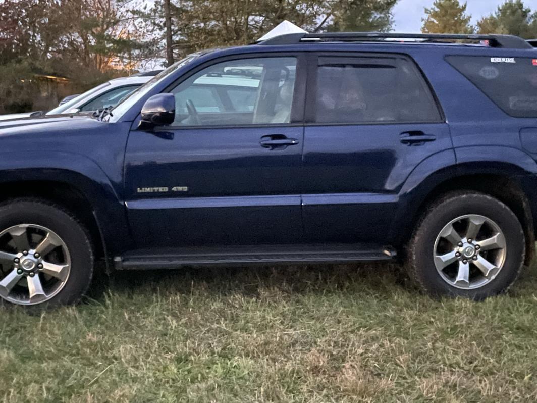

Finally got everything on and man it is like driving a brand new vehicle! Rake is gone too!
