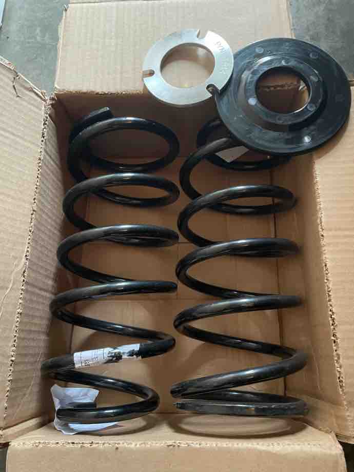

I treated myself to the final parts to complete my FJ/5100 lift. Brand new OEM rear springs and a ToyTec 1/4 topout spacer and a rear OME 10mm trim packer to correct the driver side lean.
I'm looking to complete the same lift for my 04 V6 DD. Do you have any pictures with the spacers installed?
Did you end up moving the clip up to the 0.85 settings?
Any photos or insights are appreciated.
Thanks in advance!
