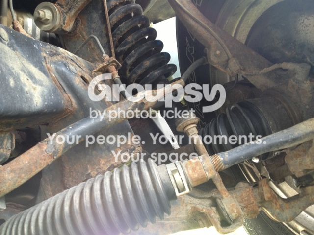

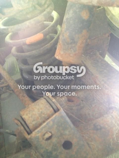

I looked under the vehicle today and this is what I saw....
image-1_zpse75f0db5.jpeg~original
image-2_zpsff9d4e82.jpeg~original

It is easy to replace the sway bar end links and chassis mount bushings. You'll need 14 mm tool to remove the sway bar end links. Try ebay, you can buy the link ends for $40 or so and bushings for like $20.
Toyota has tons of 10, 12, 14, 17 and 19 mm nuts and bolts. So keep these ready for the project.
Seems your rear shocks needs to be replaced. And it has LOTS of corrosion. Can't you spray WD 40 to prevent any further corrosion?
Cheapest place for sway bar links is Rockauto. They have Moog Problem Solvers for $20/each and they come with the bushings (links only). Usually I'd say go OEM for important parts, but sway bars are not critical. You can order polyurethane bracket bushings (the larger ones holding the sway bar to the frame) from wheelersoffroad.com (they have a complete kit but you can call for just those bushings). Very easy to replace.
Holy moly I had to do a double take - your rear shock broke off !? Well at least the hardest part is done :) If your other side is intact, you will have fun removing them. Removal is the hardest part. Do a search to see if this is within your reach.

Hey everyone thanks for your help. I didn't know the shock was broken. I thought the shock was the coil. I will defiantly check out Ebay and Rockauto for those parts.
Yeah rust is really bad. I will spray wd40 but what else do you think I should do?
