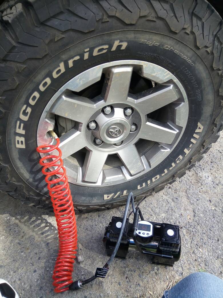

I've got a smittybilt 2781 portable compressor 5.65 cfm
It's faster than all the other compressors I've gone up against at the trail head (much faster than most). And I can do 2 sets of tires before it needs a break. It's the largest portable compressor that I've seen.
It's cheap, its passed my durability test when the bugs are unbelievably bad and I get a little rough and in a hurry.
The air chuck sucks, but it's not that big of a deal.
If it broke tomorrow, I'd replace it with the same one....
