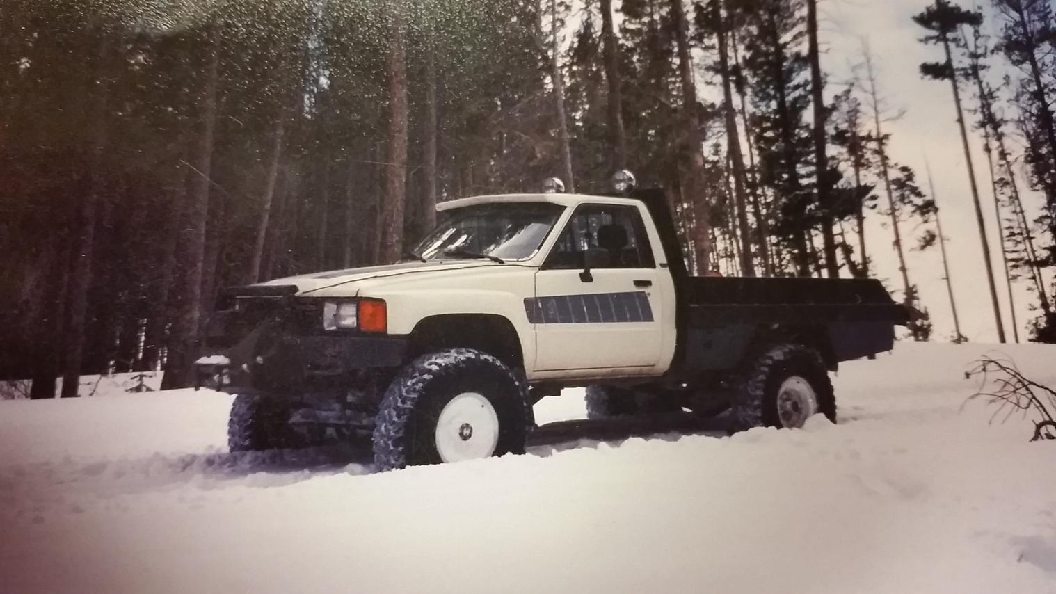

In this older pickup of mine I had a York OBA with a 12 gallon tank under the bed and a coil of air line in the bed box. It was a pretty ideal setup for mobile air compressor. But I don't think there's room to do something like that in a 5th gen short of putting the tank in the cargo area. And I'd hate to try to fit a York under the hood. I don't think it's really possible to do a PTO either.
Realistically I think the only option for mobile air to run air tools is to have a gasoline powered compressor mounted either on the roof or on a rear bumper mount of some sort. Even the Magnums aren't enough volume to run air tools longer than short bursts. They're only 2.6CFM at 100psi. Compared to a York 210 that is 5-8CFM at 90psi depending on rpms. And the York with a tank is just adequate to run most air tools.
