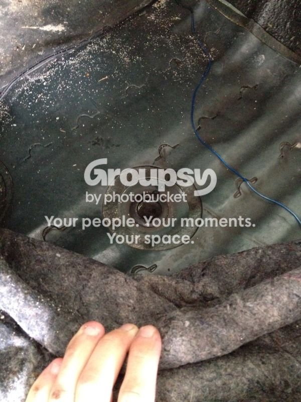

I pulled up the floor lining on the driver-side and this is what I found:
plug2.jpg~original
There was water on top of that plug. I have NO idea where it came from. I searched all inside the car and couldn't find a source from where water could come. Is it coming up form the bottom?
