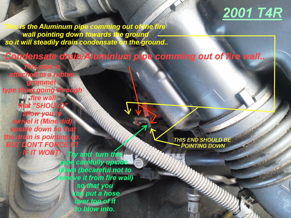

Yeah this might not be your problem but I would atleast try it if you want. Actually mine was a 2002 tacoma that was doing this not my Runner but they are very similiar! Its not gonna hurt anything atleast it didnt for me anyway! If its not comming through the wireing then what else could it be?? I really dont know!
But if you wanna try this, I drew up a little diagram for ya in a picture of mine under the hood. Mine is 2001 T4R. I think all years will turn but im not possitive on that. If it doesnt seem to wanna turn dont break it!!

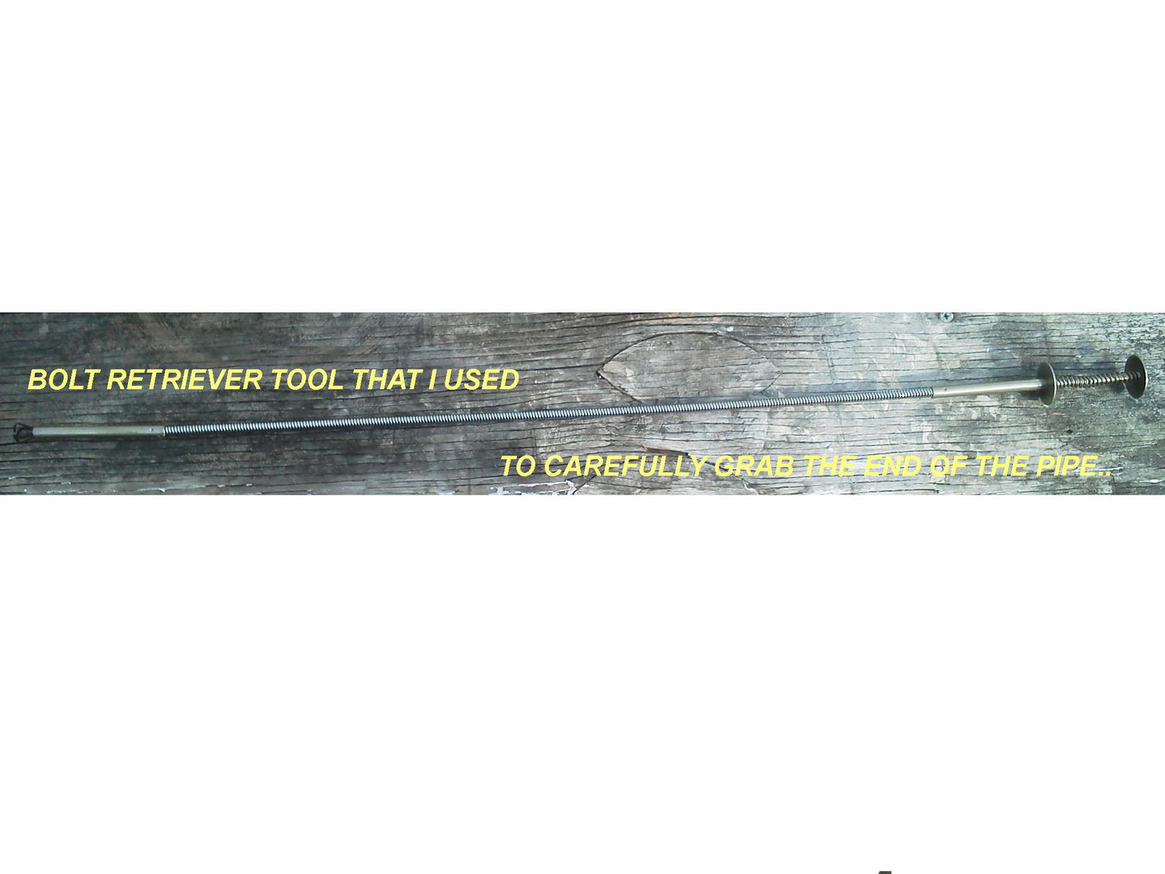

I am also attaching a picture of the tool that I used to "carefully" grab the end to turn it. (Its pretty tight in there & could not reach it with my hand)You may not have to use it but I just thought I would post it on here so that if you wanted to you will know what I am talking about..

Thanks for your help, bro. I don't know if this is the problem. I don't think I have the means to do this.
