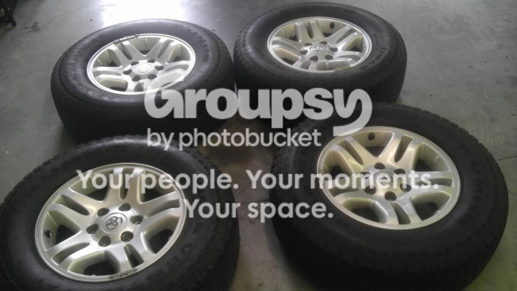

First off, I picked up a set of Tundra rims a while back.
The plan being to eventually get a chance to do the TBU and this would eliminate any issues with the calipers rubbing. Cost is a major factor at the moment so the mods are coming slow and not always to the extent that I want. With that in mind, I recently picked up some OME 890's for the rear and Toytec spacers for the front. I also picked up the panhard drop bracket.
My understanding is that the backspacing on these particular rims causes too much rubbing on the UCA's without spacers when running 285/70/17s. Can anyone verify this or not? I believe they have a 15mm offset or 4.8 to 5 inch backspace and are 17" by 7.5". I know several of the members are running them or the Sequoia variant.

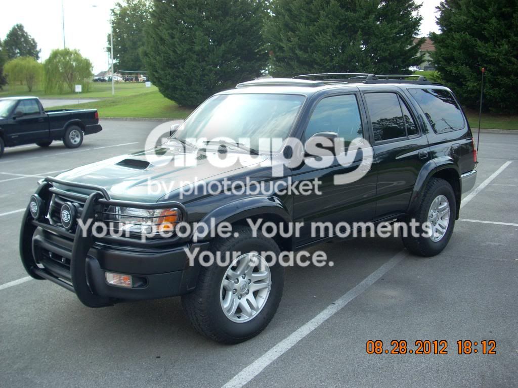

I just got some 285/70/17 Nitto Terra Grapplers installed on my Tundra rims and its super close to touching the UCA. I'm going to get spacers but decided to mount them first. It all depends on the tire if they fit but it would be better to get some spacers.
Here is the final product. It's close to the UCA, but fits.
All mounted
I'm running 285/70/17 Duratracs on Tundra wheels, Light Racing UCAs and had rubbing issues. Definitely had to go with spacers.
