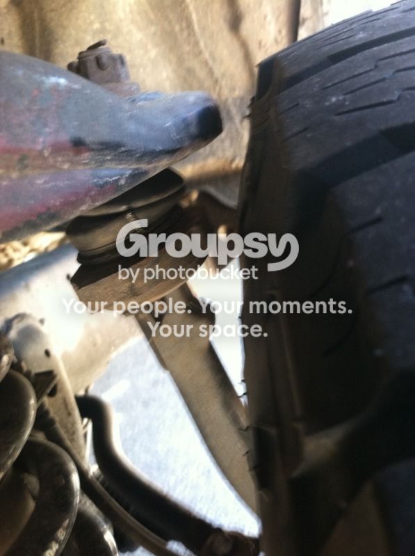

I just got some 285/70/17 Nitto Terra Grapplers installed on my Tundra rims and its super close to touching the UCA. I'm going to get spacers but decided to mount them first. It all depends on the tire if they fit but it would be better to get some spacers.

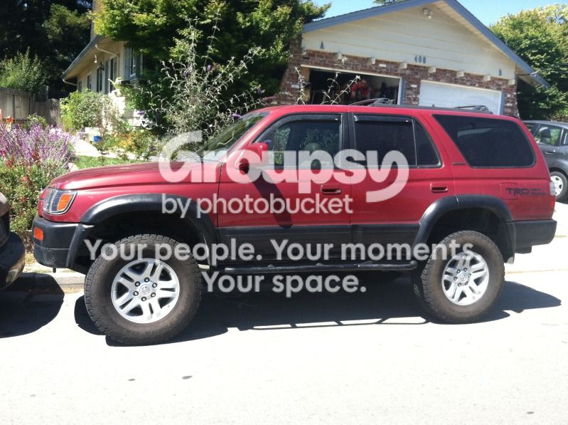

Here is the final product. It's close to the UCA, but fits.
All mounted
I'm running 285/70/17 Duratracs on Tundra wheels, Light Racing UCAs and had rubbing issues. Definitely had to go with spacers.
