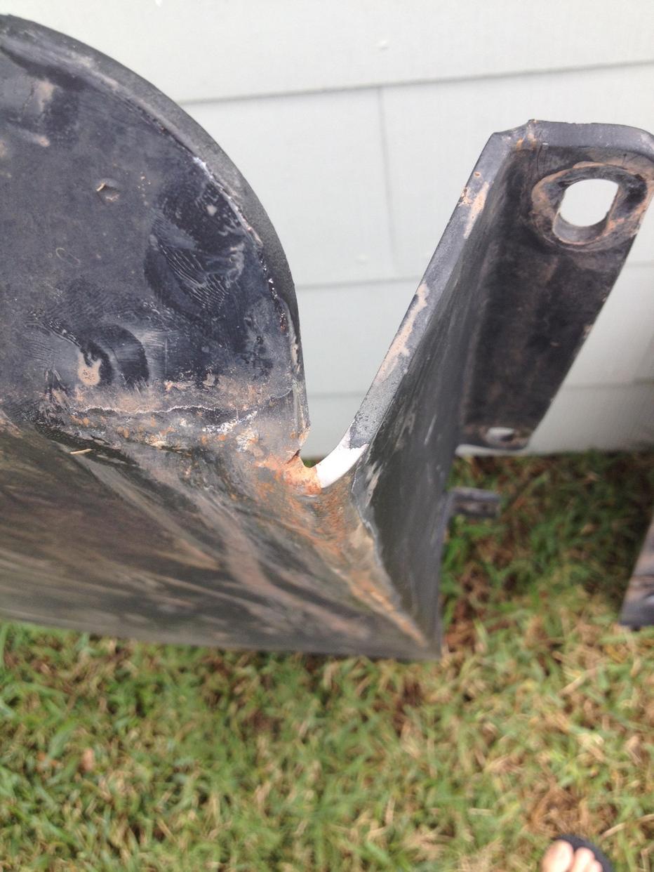

Steel skids bend, too.
Shit yeah they do. I bent the hell outta mine on Golden Spike this year. Gas tank and transmission skid are taco'd. Am replacing the gas tank skid with one that has all edges formed for strength and I will try to flatten out the transmission skid myself. Below is the front edge of the gas tank skid. The steel actually split. And I was being pretty careful. Sometimes it just happens.

At some point you may need more ground clearance. Pushing a heavy sled over rocks doesn't work all that well. That said a flat sheet of steel or aluminum isn't a great structural design. I'm sure some gussets could add a lot of strength for relatively little weight penalty.

The aluminum 1/4" skids actually resist bending more than 1/8" steel. They do gouge easier. You would have bent any skid you were running unless you would have had better support under it (or picked a better line).
Bottom line. You have to use your head and even then a skid will be sacrificed from time to time when shit happens.
