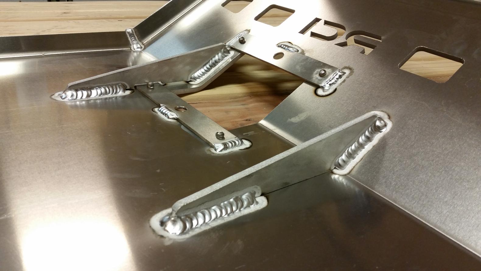

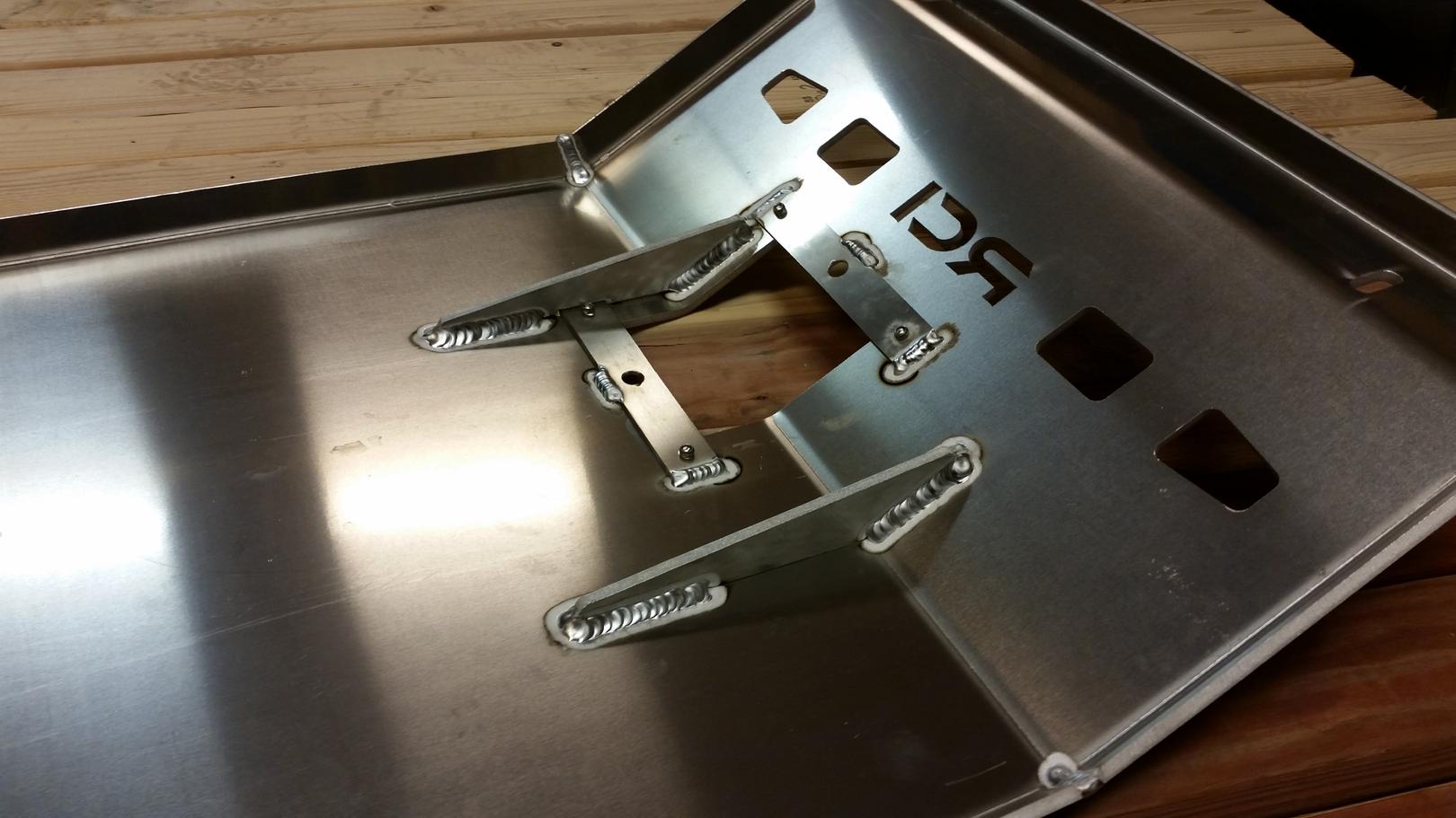

Yes, both aluminum and steel have the potential to deform. I'm not sure how long you have had your RCI plates, but all the newest versions are coming with a pair of 1/4" gussets to help resist warping.

Also, the newest generation of RCI transfer case plates have a 1" joggle rise, which not only increases ground clearance, but stiffens up the plate dramatically. It requires a new crossmember, too, to acomidate the rise in the t-case plate.

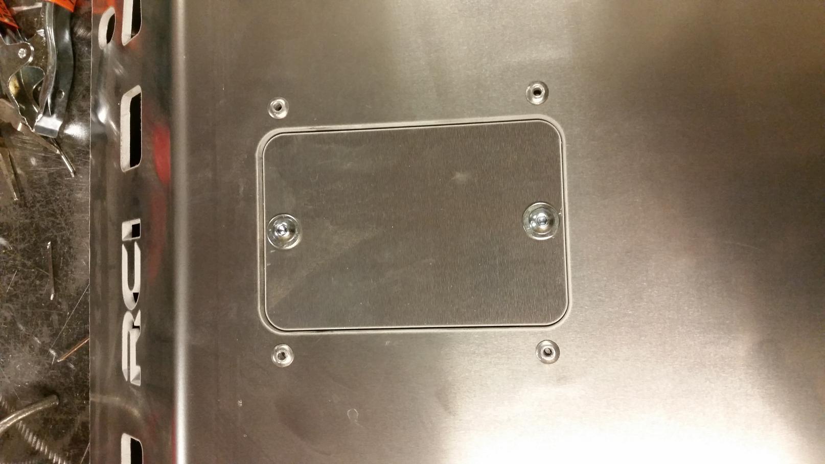

Some of the steel plates have access panels for oil changes which I like. The alu. ones tend to be one solid piece, requiring total removal for an oil change.
Not to derail the thread, but the RCI plates come with oil change access ports wherever applicable, steel or aluminum.
