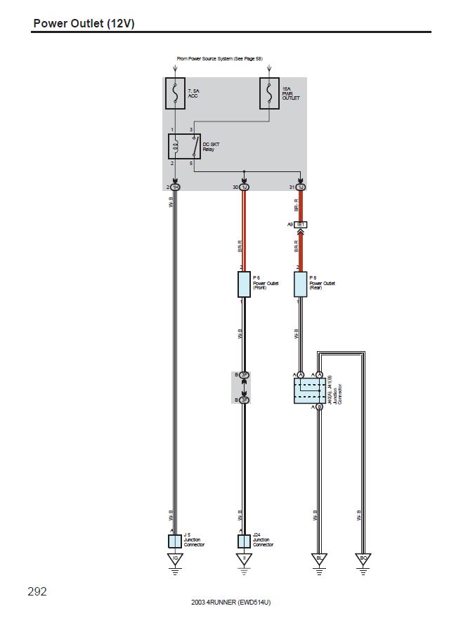

The 12V outlets both come off of the 15A PWR OUTLET fuse.

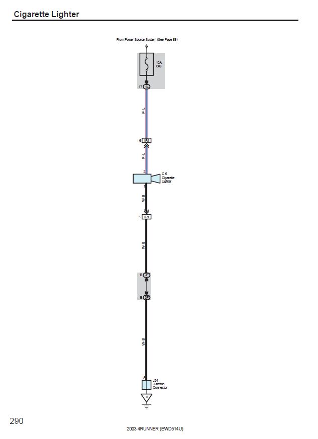

The 10A CIG fuse is for the "smokers mod" console that has a 12V outlet AND a cigarette lighter.
If the 12V console outlet isn't working, but the 12V rear outlet is, then either
a) you have a bad ground/connection to ground at the console outlet
b) the outlet itself is bad (likely due to poor/dirty contacts)
It's been a while since I've done it, but I think you can just pull the center console out, pull the center console plug, and then test for voltage directly at the plug. 12V and you know it's a bad outlet; 0V and it's likely a bad connection to ground.
Here are the wiring diagrams (from 2003 T4R) for 12V outlets and cigarette lighter.

OK, read this again and I'm confused.
OP: If you have the "smoker's package" you should have TWO 12 sockets in the center console. You should have a 12v "aux power" socket under a hinged lid, and the cigarette lighter.
The 12v Aux Power outlet is on the same circuit as the cargo area 12v outlet so if one of those works and the other one doesn't, it would have to be either the socket itself or the wiring to the socket.
OTOH, if the 12v power outlet in the console is working but the cig lighter is not, then the first thing to check would be the fuse on the cig lighter which is a different fuse from the aux power.

Today I checked the 10Amp cigarette lighter fuse and it was fine, 0-ohms resistance.
I then pulled back the console trim piece and disconnected the cigarette lighter wire. With the ignition on, my multimeter was showing 12V directly at the wire connector so I knew the culprit was the cigarette lighter receptacle.
I noticed that the receptacle had some contamination courtesy of the previous owner. I took it apart, cleaned all the surfaces and leads, put it back together and it's working again.
it looks like the culprit was contamination on the small lead (hot side) at the bottom of the receptacle.
