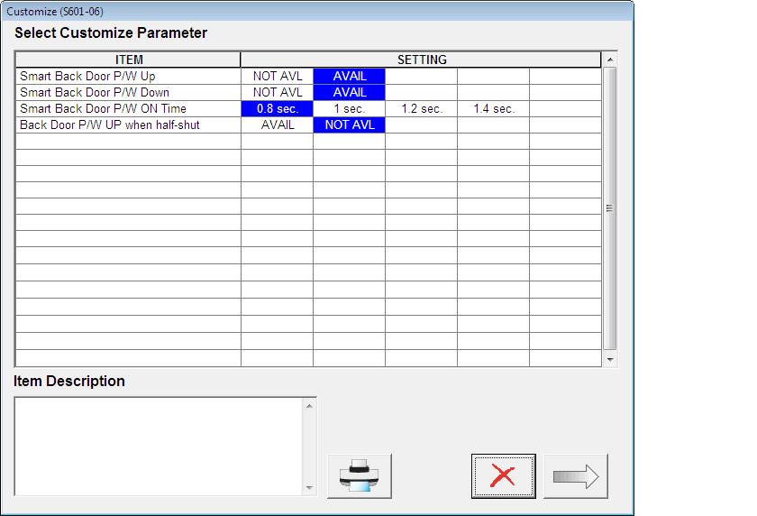

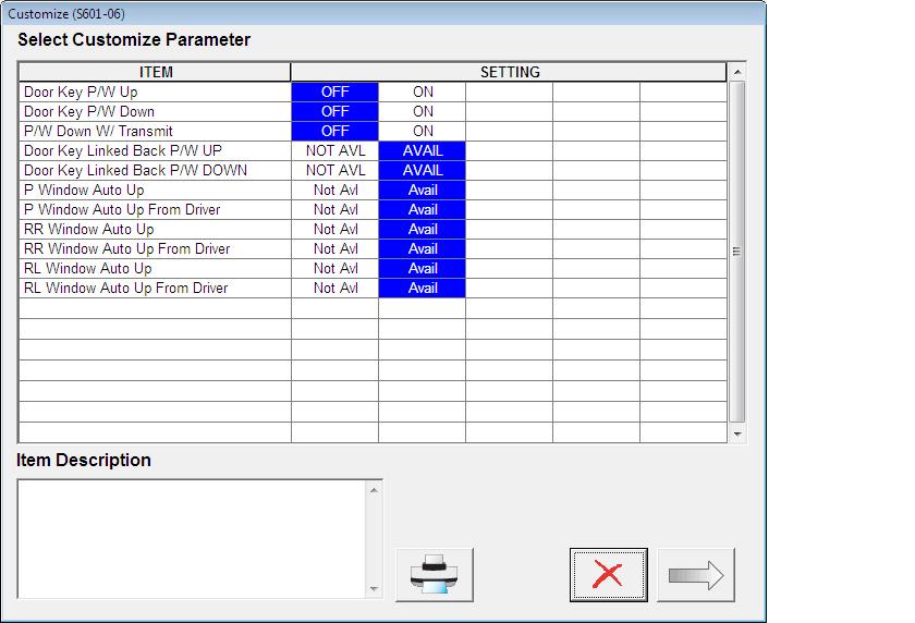

here are the techstream options
Do not know which option is the keyhole operation for the rear window. But, I gather it's available but must be programmed. The dealer did program my door windows to go down with the key-fob. I like that feature, and they did it for free.

It's the "Door Key Linked Back P/W UP and DOWN" option.
