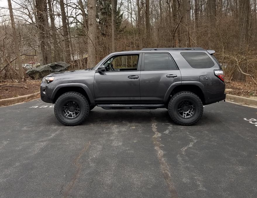

285/70/17 on stock suspension with nothing more than a fender liner mod. No BMC and no rubbing. Street driving only of course. I am now on a 295 but that's already been covered.

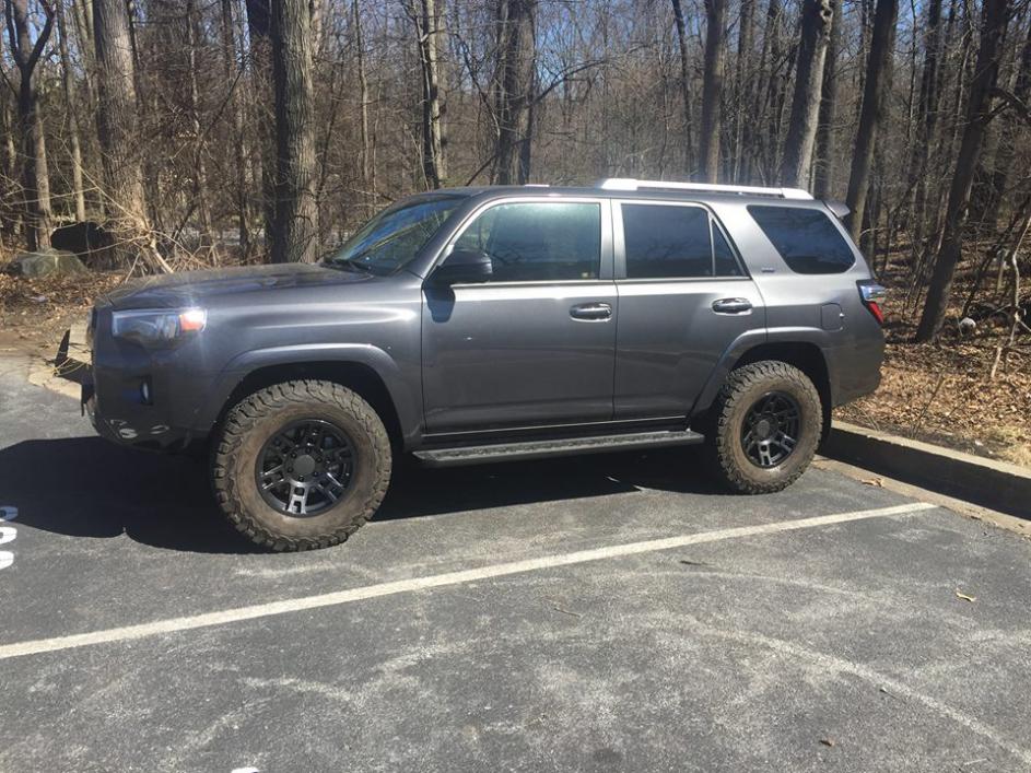

I ran the Ridge Grapplers. Worst tire I have ever had. Driving in rain was like driving on ice. They look great, good in snow, quiet on road, horrible in rain. Anyway, the stock Pro wheels are 7" wide, not even really enough for a 285 The perfect wheel spec is 17x8 with 4.5" back spacing and 0 offset. With that combo, you will have the least possible chance of rubbing. Here's mine lifted 1.5" with 295/70/17 Ridge Grapplers on MX Pro wheels. All I did is a fender liner trim, no body mount chop, no rubbing.
