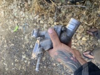

BTW.. What Basturd are you holding in your hand?
Thermostat housing?
