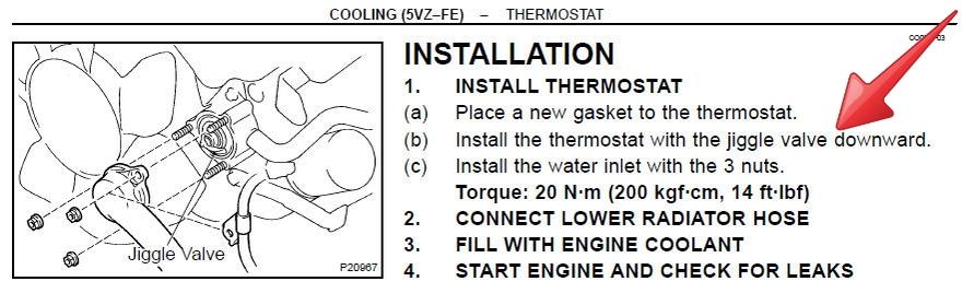

Did you install the stat with the jiggle valve down, as the FSM instructs?
Once that is verified, put the front wheels up on a curb, pull the rad cap and run the engine until you can see the flow in the top of the rad. Let it go for a few minutes, then cool it off and fill to proper level. I bet that does it.
