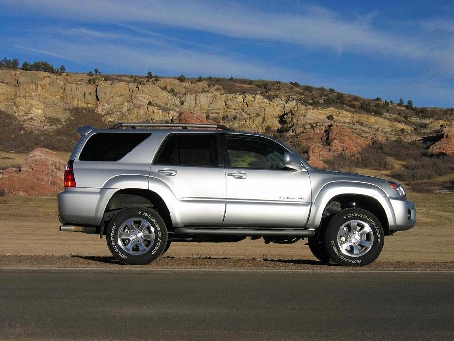

Pictures of the lift to follow.
2006 SE with 3" Cornfed lift

Looks nice!

Nice looking truck with a lift. The next thing you have to do is get some big tires; those Dunlops are too small :)

I think your lift looks great!!! Just wondering why you didn't buy a SR5 if you were thinking of taking the XREAS off? I agree the little dunflops got to go. REVO's in a larger size would be great. I don't think you need to change the wheels. The SE wheels look great. JMHO
