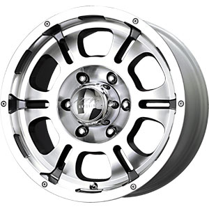

What rims have you got? Could you post an image?
Interesting design. I'd like to see how they looks on 4Runner...

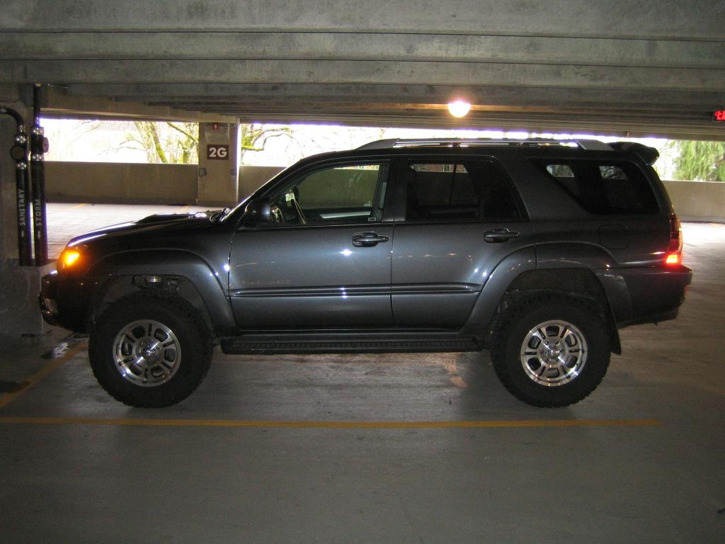

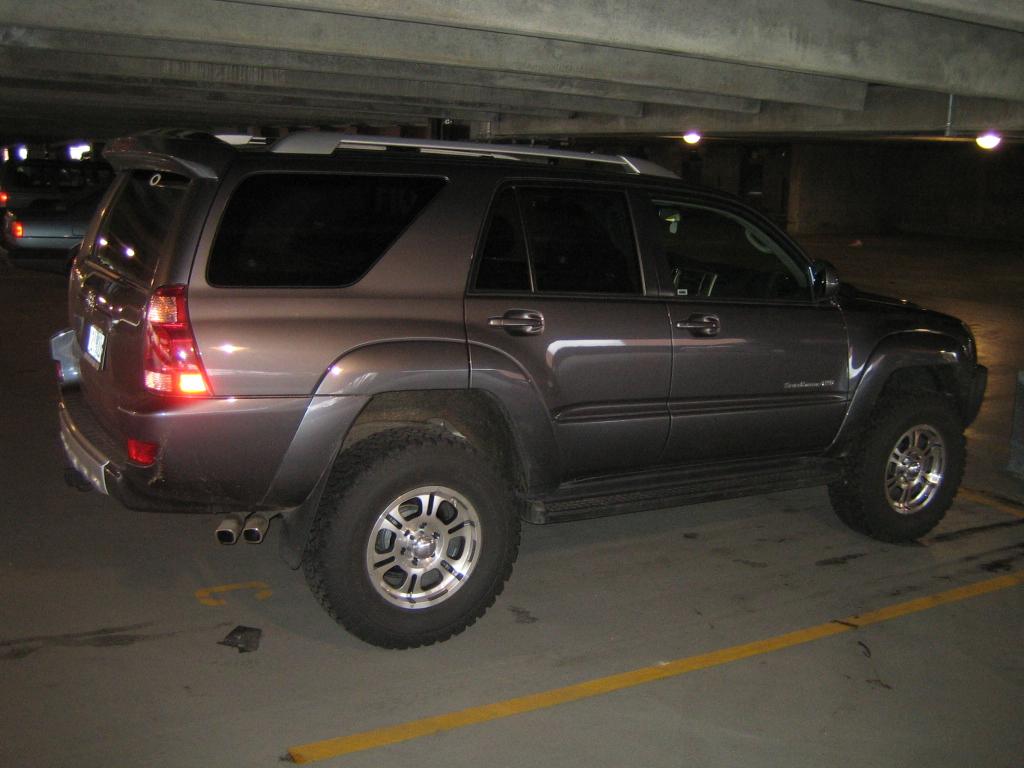

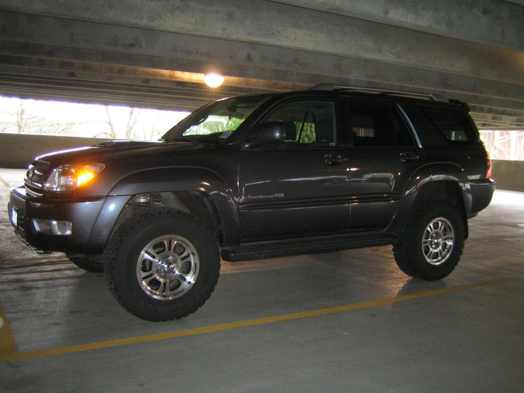

ftbjoe87 asked me to post his images. Here they are:
#1:
ftbjoe87, I like the look of those wheels on your 4Runner. Is it possible to make a daylight picture?
Yah Ill get a day time photo. Its been raining for a couple months here in Corvallis, OR so it might be a little while before I get some good day time ones. Im gonna try to go off roading here in a couple of weeks and will snap some then. Thanks for posting them.
if it's not too much trouble, can you take some side shots? i'd like to see how much the wheels stick out the wheel wells.
thanks
great looking truck BTW! :bigok:
