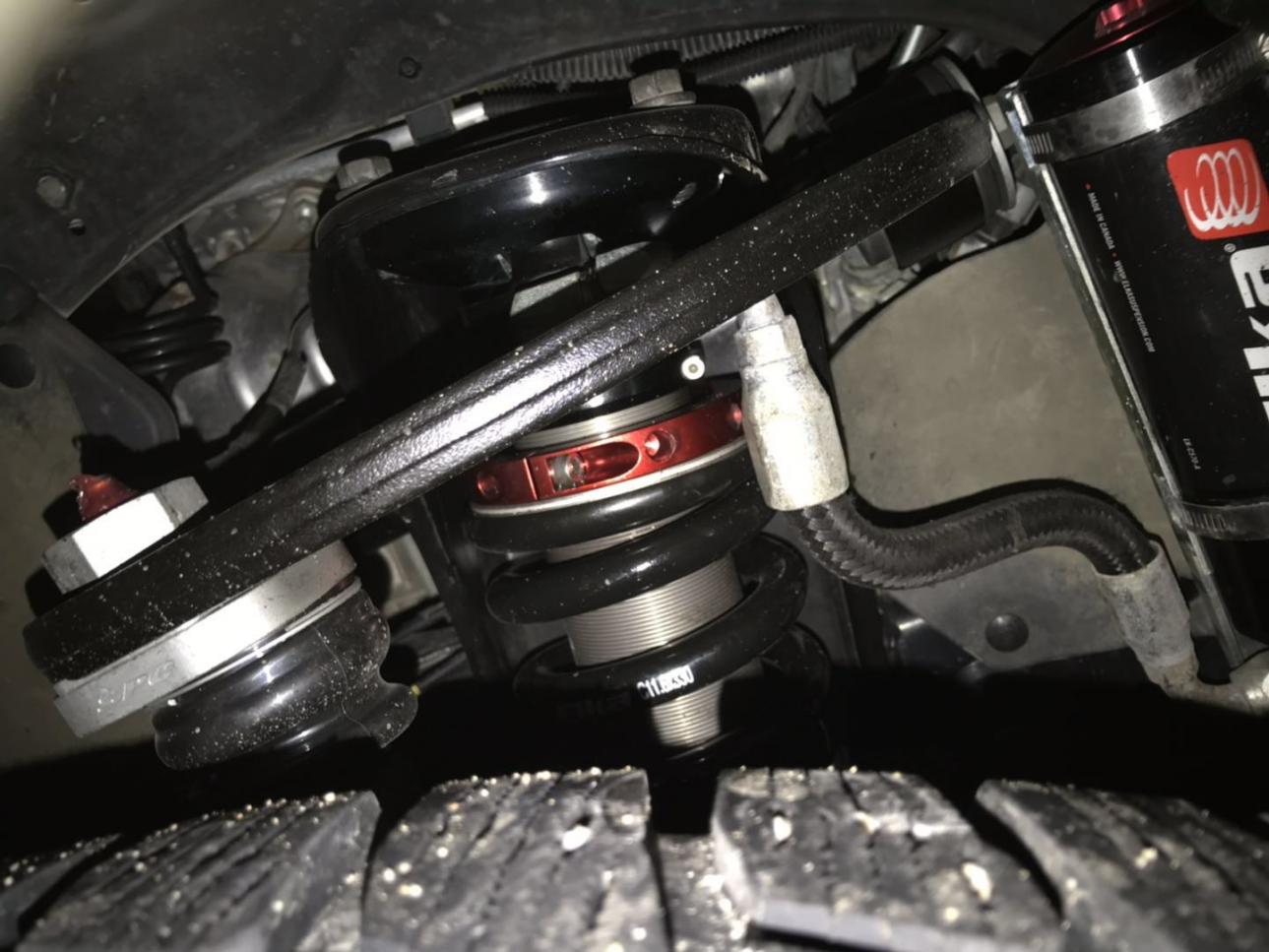

Elka owner here who drives a 4Runner as a daily driver and does occational off-roading. I contacted Elka about the frequency of maintenance and they recommend a rebuild every 50K miles based on my application.
