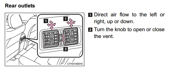

Don't mean to insult your intelligence OP, but do you have the vents fully opened (see picture below)? lol
I can definitely feel air coming out of the rear vents, I just tested this earlier. If you want to test something to see if there might be some blockage along the path, close off all of your front upper vents and open the rear vent; with the air flow directional knob set to the upper vents test and see if you feel the air coming out the rear vent now. Doing this should definitely provide you with substantial air flow because you're essentially directing most of the air straight to the back.

Yep the vents are open etc
