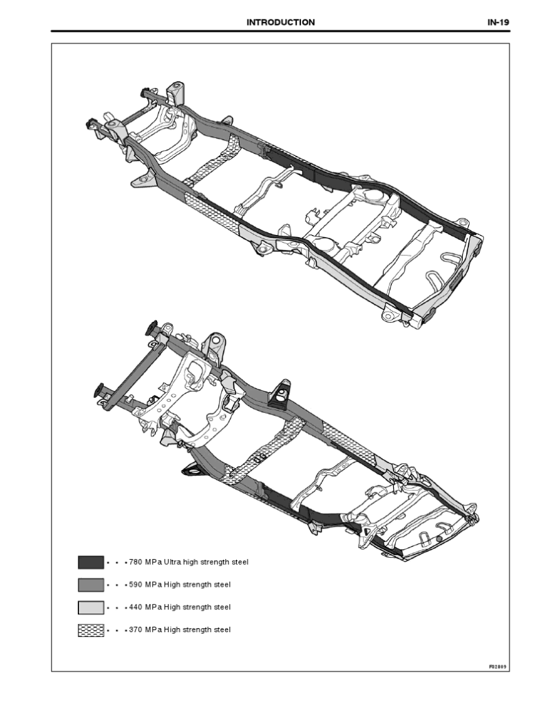

Front bumper is mounted on some high strength steel, which should handle some 200lb extra weight. But the frame cross members don't seem to be high strength. I'm thinking maybe the frame got twisted because of uneven tow/hit?

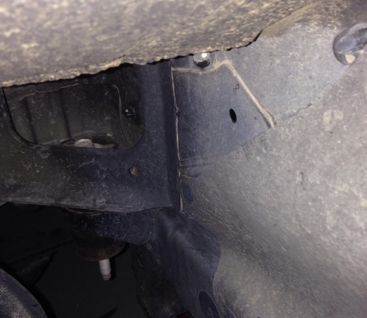

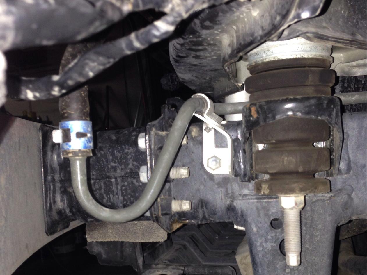

I have my front bumper off right now ready to install my SW bumper. As I was looking in the fender well and the front end where the bumper will mount to the frame. There is a rubber stopper/absorber which is connected to the frame a little bit behind the mount. This rubber stopper is also connected to the same area a little bit below where you guys have the stress cracks. Here is a pic of the rubber bumper/stopper. Maybe this can have a little insight of what's going on.

In this pic you can see that the rubber stopper/absorber connects to another sheet metal then connects to the area of where the stress cracks are happening.
