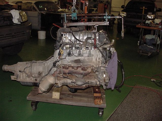

The stock headers on both of the 2003 V8's I have are not cast iron. They are made out of tube steel, like aftermarket headers. I pulled two engines for an engine swap and removed the heat shield to look at them. Look in the picture I have the heat shield off.
In most cases when you replace the stock parts with an aftermarket header it makes it LOUDER since the tubing used is usually thinner so I don't think your conclusion is correct.
