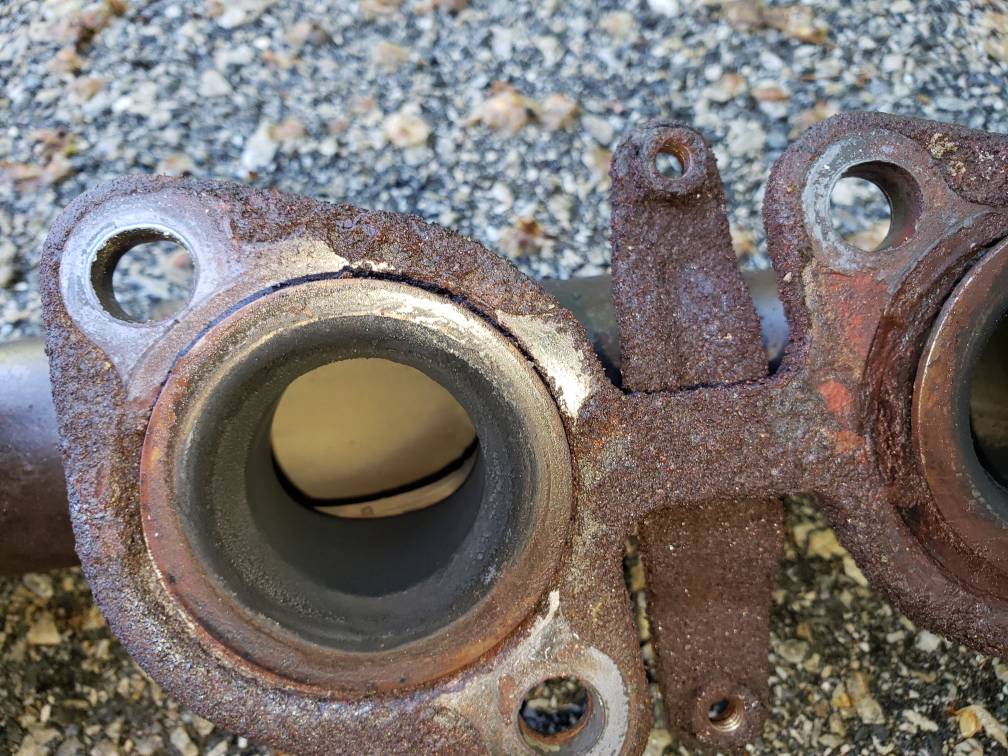

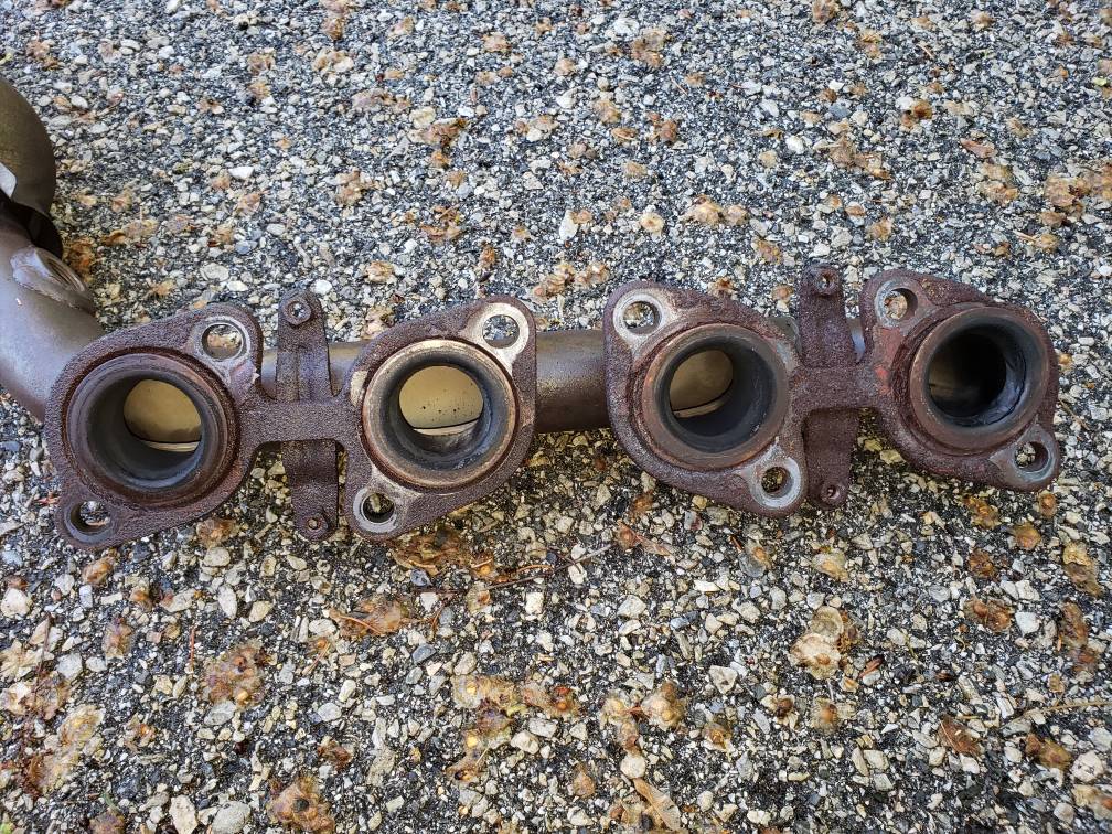

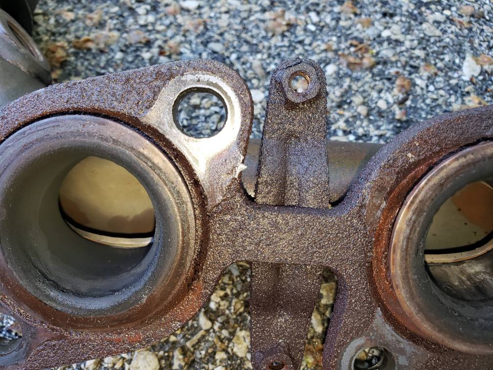

So I just replaced my passenger side about a week ago. I have not located a crack on the old part. But I really didn't look all that closely. My Toyota Tech buddy thinks it was a warped flange. And not a crack.
Sent from my SM-G965U using Tapatalk
We had the same exact though process. Both of my flanges looked very similar to yours and the thought was that rust may be causing deflection/warping of the flange and that was the exhaust leak. I kept the old headers as they looked fine inside and out.

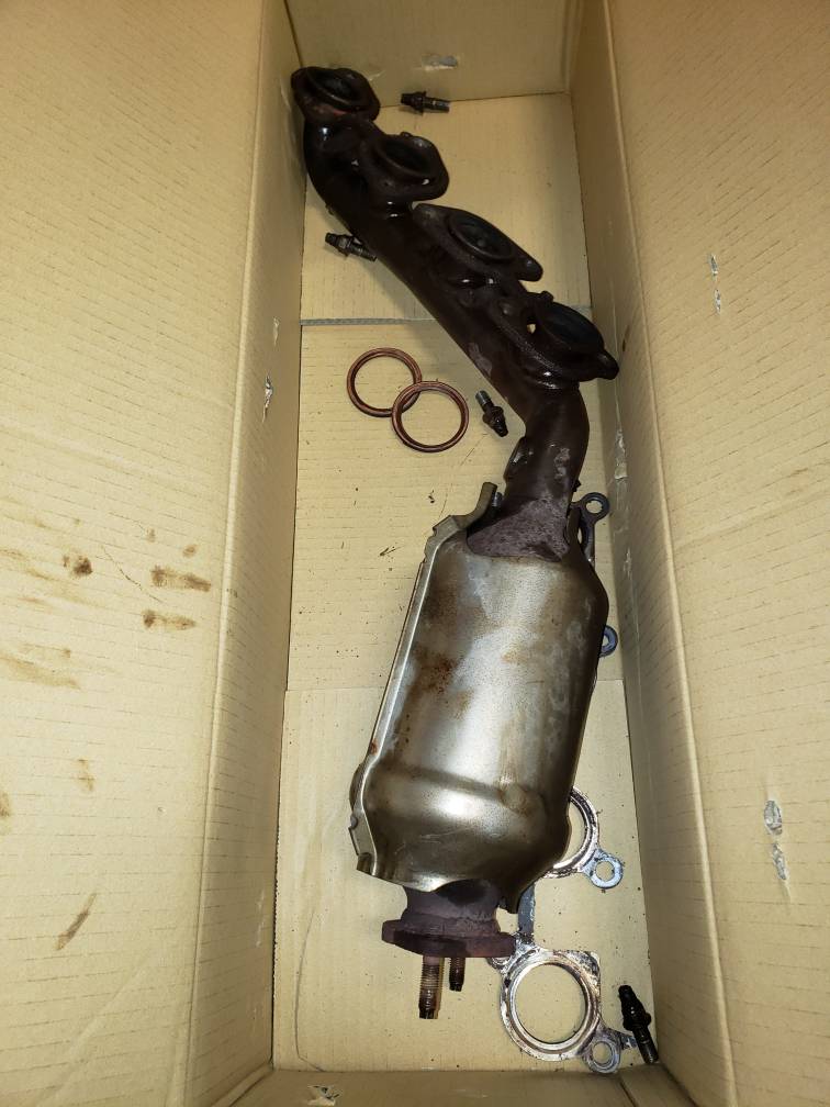

An update on my situation:
- mechanic could not find any actual cracks in the manifolds themselves
- he gave me the option to replace only the gaskets, which were nasty with rust / corrosion
- I carefully considered and chose to replace both manifolds anyway (I'd already had parts shipped in and he does great work super cheap, so I want to get anything done by him that I can)
Most importantly - the damn thing is now silent as the night.
So happy.
P.S. I was hoping the cats were dirty such that I might get an MPG bump; nope, they were clean as a whistle.
Interesting. Warped flanges seem like it. That's some thick metal and welds to be cracking around the seams. Those replacement headers would be dope. Smooth curve, transfer into one pipe before the cat. I've sprayed 'em down and getting ready to wrench off and have a looksie. If I get the same result I might put the piece on an anvil, heat with some map and try to straighten by banging or with some high grade bolts onto an equal metal surface as a clamp point. I was about to post asking what type of stainless steel the OEM header is. I guess it would be 304 and 409, effects my choice of shielding gas if I'd be trying a MIG repair. Already passed inspection, so it's not critical unless I try towing again. Reg. gas and a trailer turned my CE light on a couple times during a haul through the weather at grade. It's getting there.
