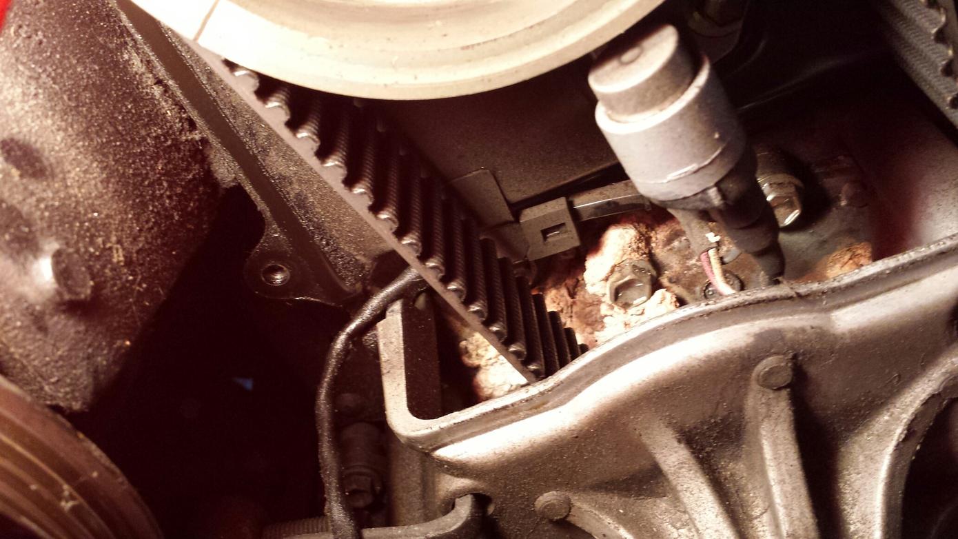

Thanks for your input. I ended up removing the fan and leaving the belts in place. I made a tool using a piece of LVL lumber and 2 - 3/8" grade 8 bolts to hold the HB in place. The tool worked great. I had a few other things to do today so I'm just filling it up with Super Long Life. Hopefully all is well. Thanks to the Durk for the tool idea.
Here is the calcified water pump.
