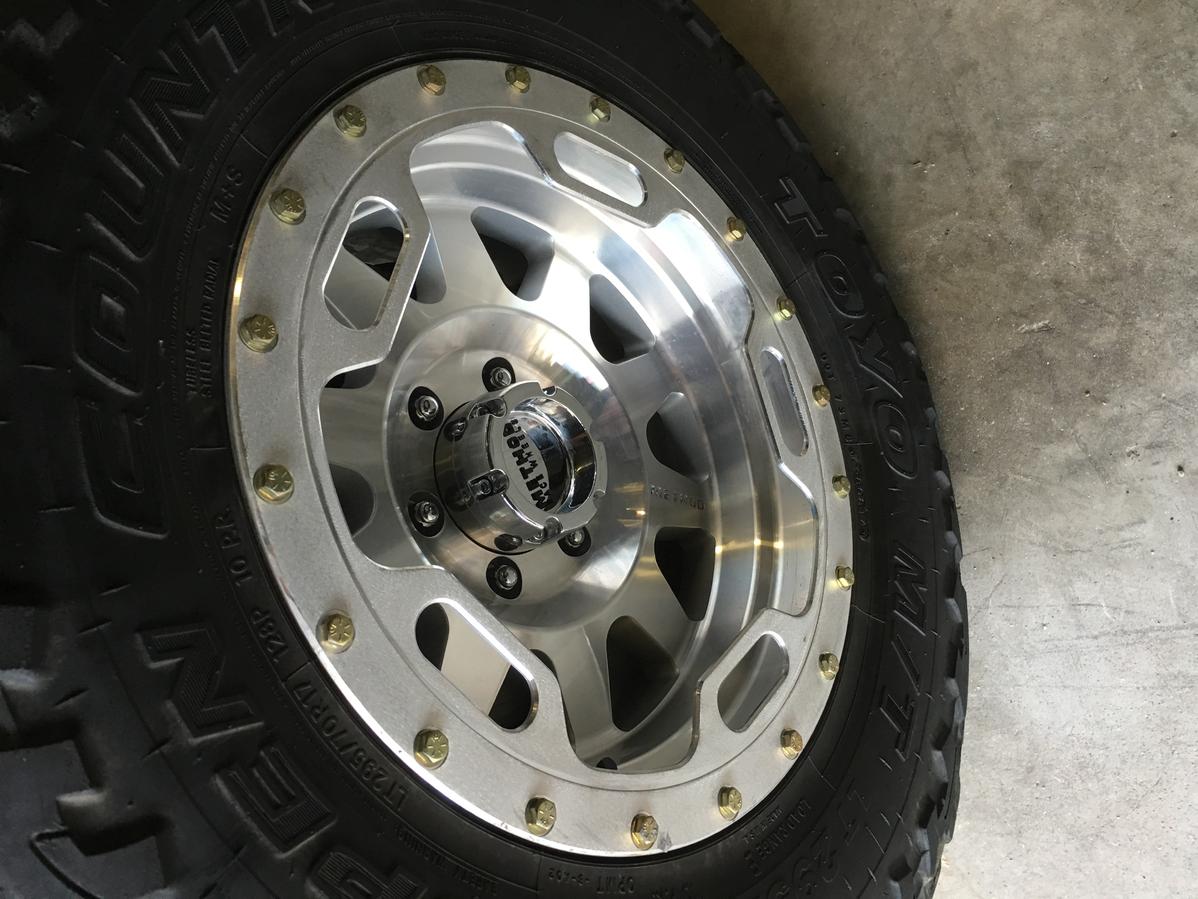

Just got the rock rings
What do you guys think this is with the old bolts

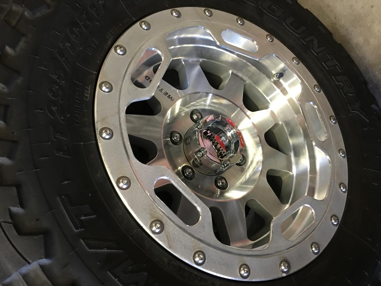

This is the new bolts

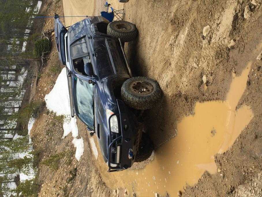

I went out one time and pulled one out in a mud pit these should be less likely to get caught up

Yes I had to custom cut bolts for this I went with button head hex and made them go almost to the bottom of the holes, I have been off road with these and hit them a few times, bent one in pretty good and the bolts held up I bent the ring back in shape and all is good so far
