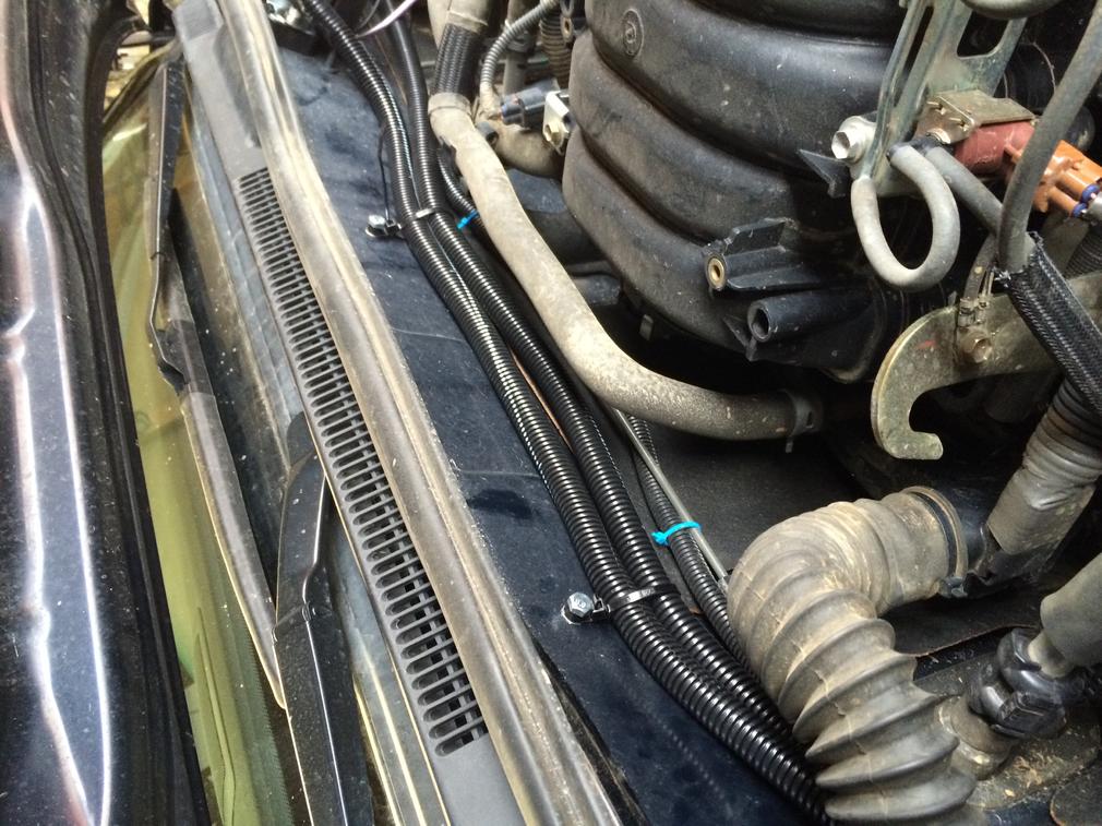

First I ran the wires up from the side but it got in the way of the hood strut so I ran it from the back

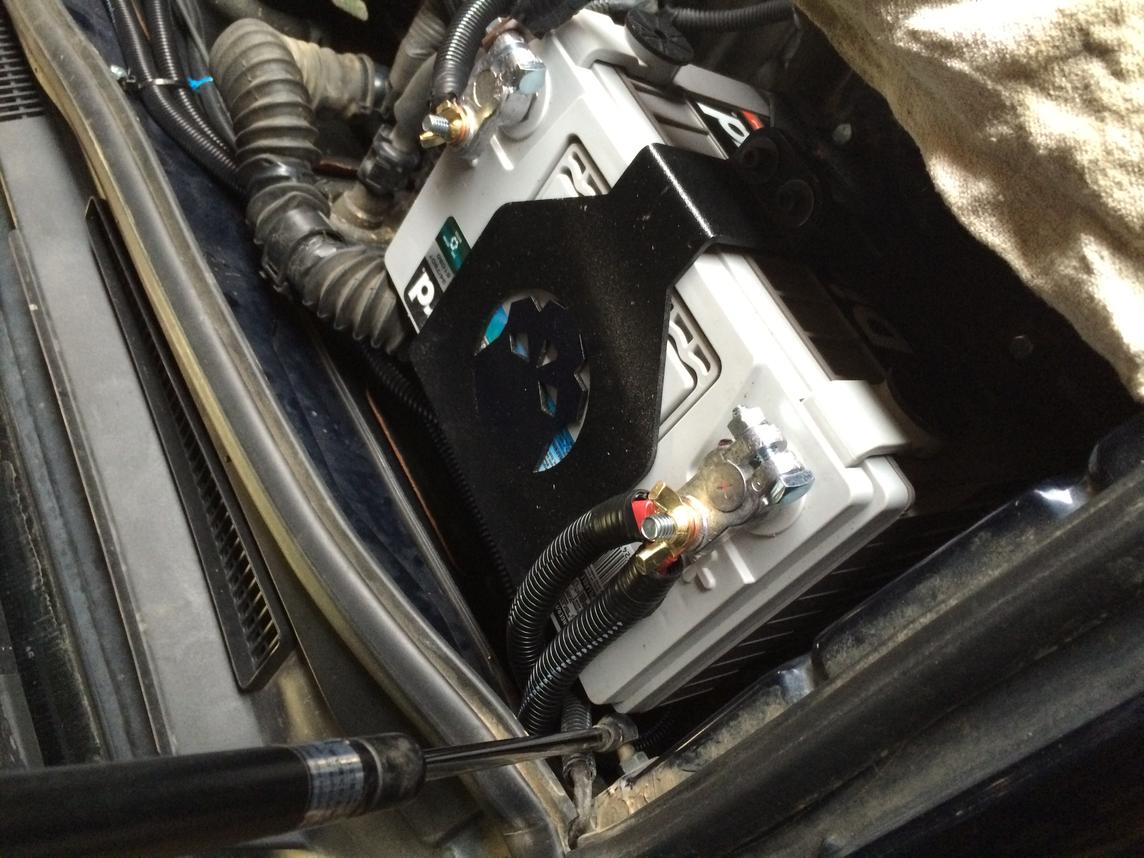

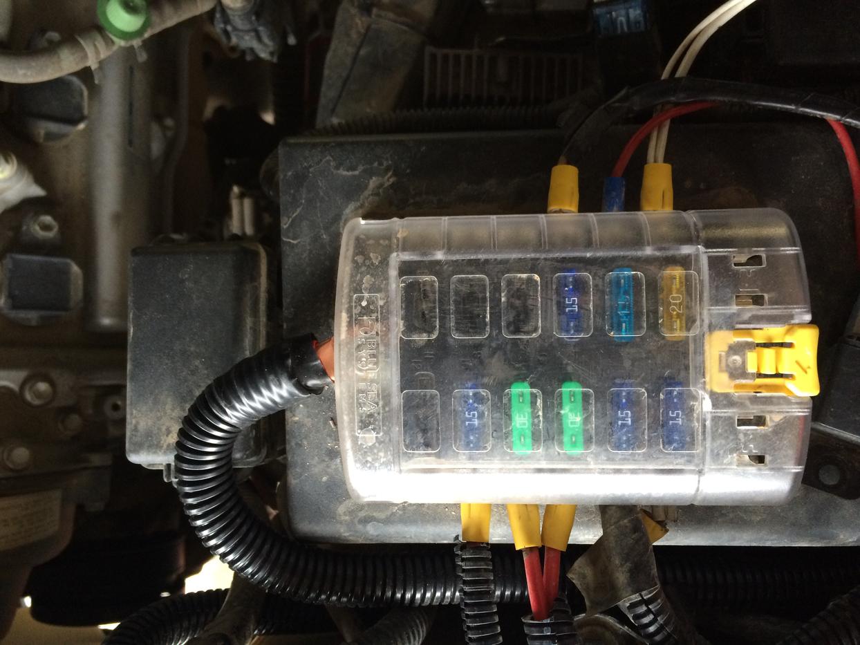

Lastly I removed the 2nd fuse block from the main battery and moved it to the 2nd battery

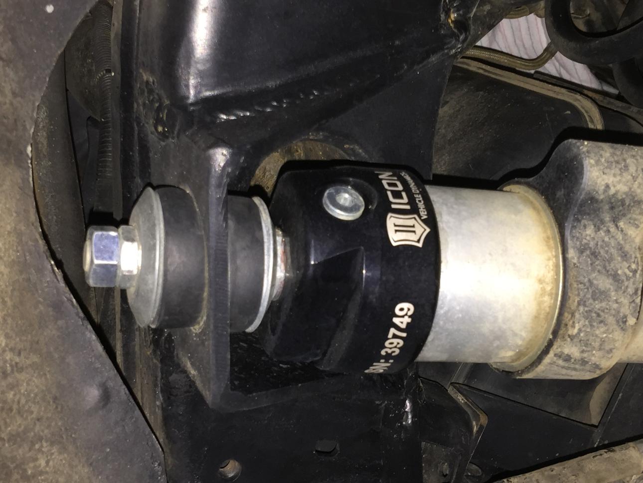

I had to bring it up to addicted off-road and Scott cut out the old shock mount then boxed the opening an welded a new mount to move it 1" out from the frame
I needed the 2.5" for the weight of the bumper and gear when I'm fully loaded I tried the 2" shocks but the rear bounced all around to the point I heard the bumper slapping the water when I did the water crossing and when I came down off a ledge or rock I would hit the 2.5" handled it much better!
I did upgrade to the compression dampening control shocks (CDC) so I can play around with them but now I have something new to learn about lol
Have any pictures of that shock relocation bracket they made ? I have a pretty good idea of what it would look like just want to make sure I'm on the same page , nice write up on things and clean ride .
Did the battery box for your second battery install without any problems? Just bolt right in? I think I'm going to pick one up, just want to make sure it won't be a project to get it bolted in.
I needed to make a couple of simple brackets and move the main working harness not a big deal
Here is a close up of the shock mount they made the parts to relocate pretty stout

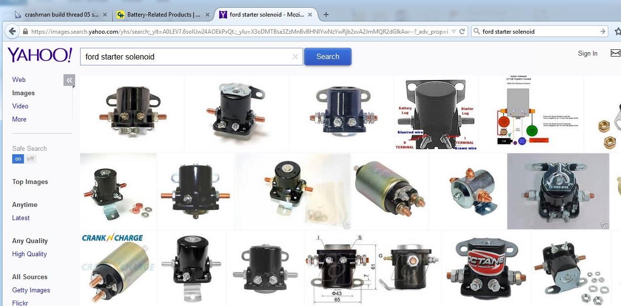

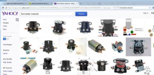

That battery isolator is basically a Ford Starter Solinoid. I'm sure it will do the job, but traditionally a unit like that is only designed for short bursts of current i.e. a Starter, not long duration loads. Perhaps the lower current draw is what makes it acceptable for that application.
I have no doubt you did your research and its an acceptable product. So not knocking it at all, just wanted you to be aware. Electrical fires are bad :nod:
Wow that's intresting!!
This one is the 200amp but it should just charge the battery not run anything or am I missing something?
Yes electrical fires are bad

Can you explain in detail what/ how the soleinod is engaged?
I know what that is because thats style switch is what most lowrider guys use as solenoids on their hydraulic pumps. But even Hydraulics are momentary similar to a starter, albiet higher voltage (24-72v).
Like I said... it could be absolutely 100% fine.

This on does pretty much the same thing with one additional option the "jump" function
It monitors the main battery and when it gets up to 13 volts it closes and starts charging the 2nd battery it will keep them connected until the car is off then when the voltage goes back down to 12 volts it seperates them or if the 2nd battery starts draining it separates them
However if the main battery is drained you can push a button and it connects them so you can jump start yourself without cables
Looks can be deceiving. Although that isolator does indeed resemble a Ford starter solenoid, that doesn't mean that's what it is.

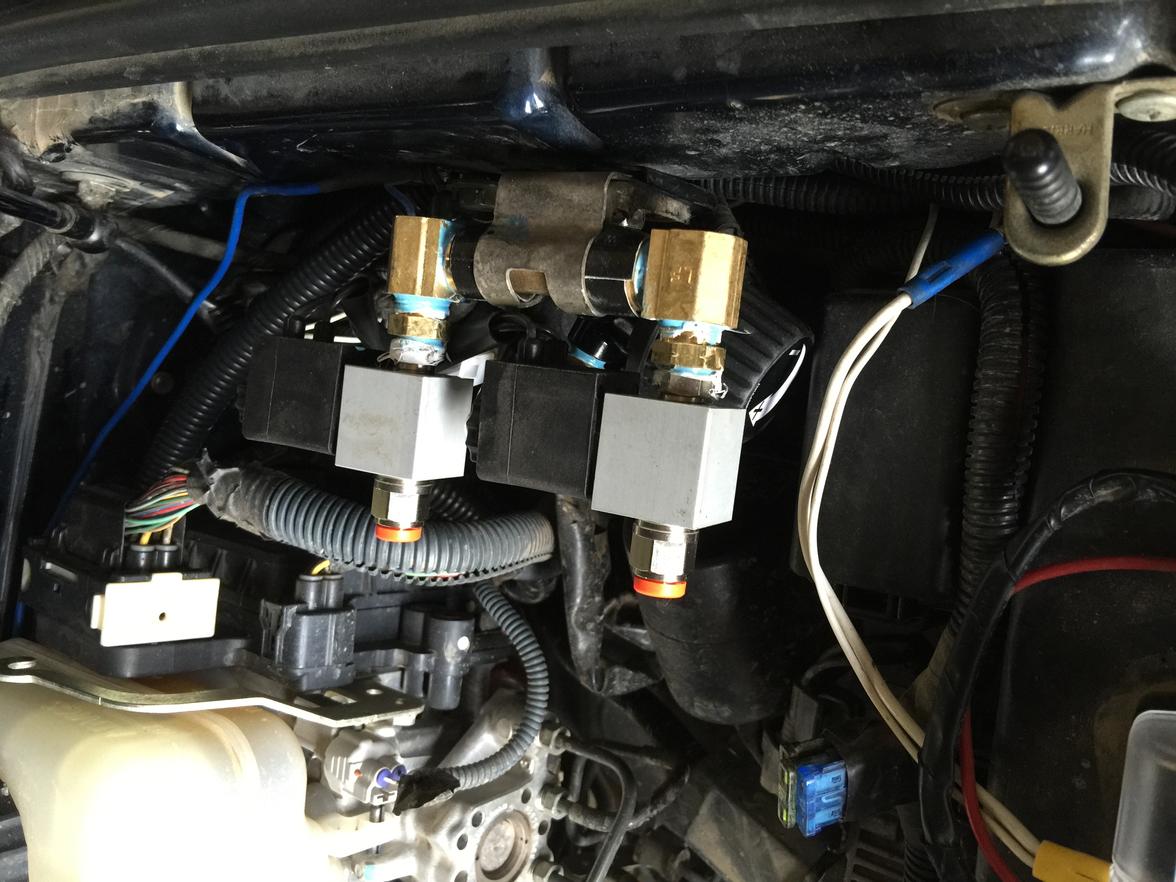

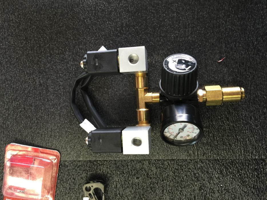

Well I started plumbing in my air locker solenoids I started with a manifold
Then modified it to fit under the hood
It's close to the hood strut but I think it clears
