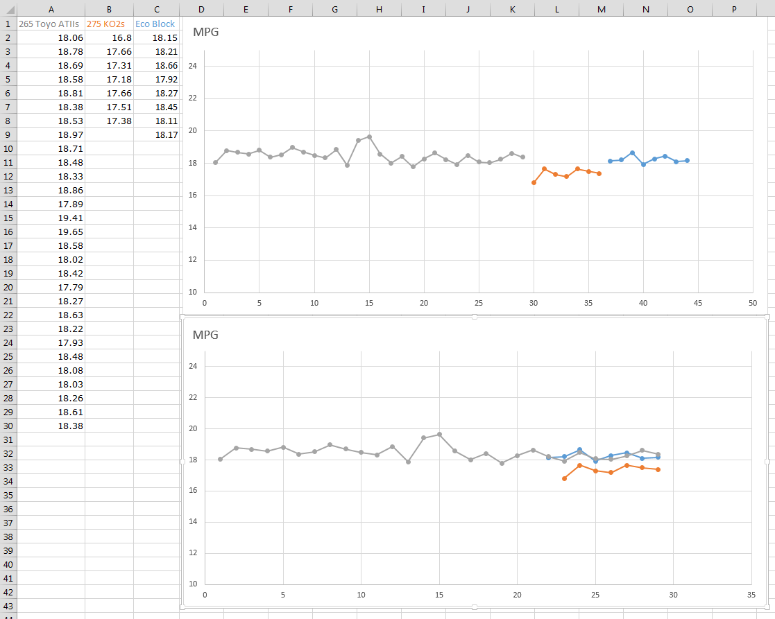

I Added 2 more tanks to eco block group and plotted mileage...
After plotting the data, the changes from stock to over size tires, then the addition of the eco block becomes even more clear.
There is a slow downward trend in my stock MPG over time, likely due to my adding bumpers, winch, battery and skids during that time increasing weight. However the last few tanks seem relatively stable as I slowed down my "building". There is also no indication of any seasonal change in MPG due to gas reformulations, we have low MPG gas here year round now :(
Laying the KO2 sequence and finally the Eco Block added sequence on top of just the end portion gives the clearest picture of the MPG changes due to those two items.
Calculating only the last 8 fills of the stock/no eco block sequence instead of the entire thing and the numbers look like this:
Lifted, 265 (stock size) Toyo AT2 tires
18.22 + 17.93 + 18.48 + 18.08 + 18.03 + 18.26 + 18.61 + 18.38 / 8
18.249
Same as above but 275 BFG KO2s
16.8 + 17.66 + 17.31 + 17.18 + 17.66 + 17.51 + 17.38 / 7
17.357 - 0.892 MPG
Same as above but with the Crawford Eco Block
18.15 + 18.21 + 18.66 + 17.92 + 18.27 + 18.45 + 18.11 + 18.17 / 8
18.24 + 0.886 MPG
Results
* 0.9 MPG drop from Stock AT to 275s
* 0.9 MPG increase using the MAF spacer with all other variables constant.

What's wrong with this tread? He's giving real data (and yes I realize there are tons of variables that go into fuel economy numbers) and this is a better thread than one of at least 5 started this summer about the 2016 4Runner and numerous other topics that have been beaten to death and then had their lifeless corpses beaten further.

Yeah, I mean I recognize that it's a bit of a dead horse, but people were asking for data and I decided to silently collect some and just show what I found. It takes a LONG time (months) to collect MPG data before you can begin to see patterns, so bringing up a dead subject is the only way to present the info...
Anyhow! I think I've done all I can here. It's already paid for itself in gas savings and I'm going to leave it in for the time being.
