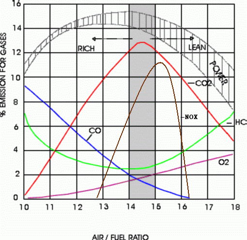

From this emissions / air fuel ratio diagram I can see that our Eco Block Fuel Saver raises the CO2 as well as the 02, while lowering the HC and CO.
Look closely at this diagram. It represents the Exhaust Gases relationship to the Air/Fuel ratio that enters the engine and the Power output of the engine. As they say a picture says a thousand words. Ideal Air/Fuel Ratio is 14.71/1 (for petrol) and not consequently this is where the CO2 is at about it's highest percentage and the HC at it's lowest. The Power graph highest point is also almost there, so these should be your guide lines. Also notice that the CO and O2 have almost the same (low) values at the "ideal" point ( the gray area on the diagram). Don't forget that all gases relate to one another so if one is out of range it will reflect on the others too.
So to recap: The highest CO2 with CO and O2 with same low values and the lowest HC you can get and you have almost the perfect picture...pardon, engine combustion! Enjoy!
Was it ever addressed what stops the ECU from adjusting the fuel to get the Air/fuel ration back were Toyota programed it by using the feedback from the O2 sensors?
Its been along time since I rehashed this thread but my recollection was, spacer for MAF causes the ECU to think the engine is getting less air then it actually is, therefore it runs lean however presumably the ECU is also getting Feedback from the O2 sensors to keep the A/F ratio where it wants - what keeps it from adding more fuel to get the A/F ratio it wants from the factory?

I think most everything was discussed in this thread, especially the closed loop function of the ECU. But to answer your question again, the ECU keeps the air fuel ratio at 14.7 to 1 while in closed loop regardless of our Eco Block. Although the ignition advance is still there during closed loop fueling.
