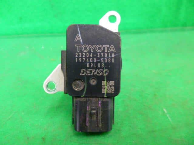

Quirt,
I've got a denso 197400-5080 and its not listed on the application chart.
2010 SR5 premium. It looks like the same shape as any other Denso MAF but just want to confirm with you.
Toyota has gone to the newer / smaller MAF sensor on your 2017 SR5 so the correct fitment will be our Q2.

Quirt,
This is the second generation denso sensor which takes our Q2
