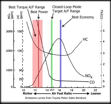

I don't know much about it. IMO using electronics is the correct way to modify the signal. I'm a physicist by education - so I could sort out the fluid dynamics to make a spacer for lean burn during WOT - but I wouldn't. I'd tap in to the electronic side. It's a much more precise way to tune it. A good analogy would be moving your thermostat to a cold place in the house to warm it up as compared to turning the temperature up on the screen. It does mostly the same thing. One is controlled. The other is more of a crude guess. The O2 sensor effectively flutters around the ideal AFR - so in closed loop the readings from the MAF sensor are probably only considered on a "nominal" number basis and used for verifying the fuel trim. The primary fuel balance is performed on the backside through the O2 sensors. However, the gas pedal is really more of an air pedal, so you could possibly adjust throttle response to some degree. When you press the throttle it's calling for x amount of air, if you trick it to think it's less than that, it'll act like you gave a little more throttle, but it should also re-balance fuel trim almost instantly.
In WOT the fuel map is probably designed for something like 12.5 AFR. According to Toyota that's where peak power/torque lives. This depends on engine design. Not all engine designs have similar ideal AFRs. Part of the reason they run a little bit rich in WOT is to account for things like variation in fuel delivery, air flow between cylinders, etc. So running 13 AFR (leaner than OEM) may mean that 4 cylinders run at 12.9 and one runs at 13.1 and one runs at 13.3. 13.3 is too lean. So you could end up with accelerated wear on one cylinder for example. With Toyota's typical very conservative tuning and build quality it's probably pretty unlikely. But still possible.
The big advantage to doing it electronically is that you can tune it to work under certain situations. For example you could adjust the signal only above a certain flow rate, so it would function only during WOT and above 4000 rpms. Or - only during WOT and below 4000 rpms. Or any variation of that. Either way it's likely only going to work at all during open loop mode - and that's pretty rare on these engines. It makes a pretty dyno chart, but probably does very little for 99% of your miles.

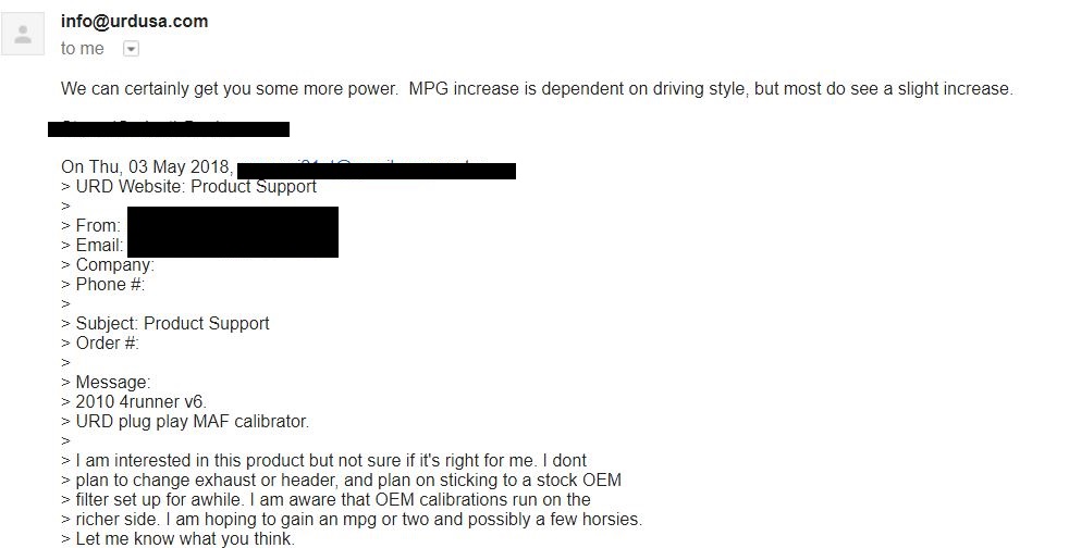

the problem i have with this is that everybody lies. They want to confirm that they're doing better than they really are to justify the purchase. Or they're comparing different driving circumstances. The sprint booster just changes the pedal position. So you could drive exactly the same by moving your foot a little further.
god damn it everyone just want to take our money

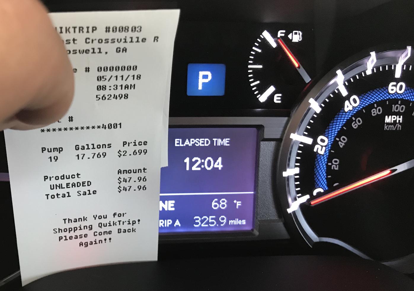

I bought the EcoBlock a few weeks ago and installed it this afternoon on my 2017 TRD Offroad - stock. I will post my findings in a later post. I see roughly 19 - 20mpg on an interstate trip. In the city I am getting about 16mpg.
I bought this to see if I could get better fuel economy. I did not buy it for increased torque or horsepower.
Installation took about 5 minutes - the tricky part is making sure the o'ring sets and doesn't fall out of place. Took me two attempts to get that done - other than that it is just 2 screws that are supplied in the kit.
Here are the results from the first tank of gas after installing the Ecoblock. I would estimate this tank at about 60/40 city/highway.
The total drive time was right at 12 hours - there were about 2 hours of that where the 4Runner was idling while I was taking phone calls and not moving.
325.9/17.769 = 18.3 mpg
I'll let you draw your conclusions from this data point.:cheers:

60% at 19-20mpg and 40% at 16mpg is 18.4. So you saw a 0.1mpg decrease? Must have been all those phone calls.
