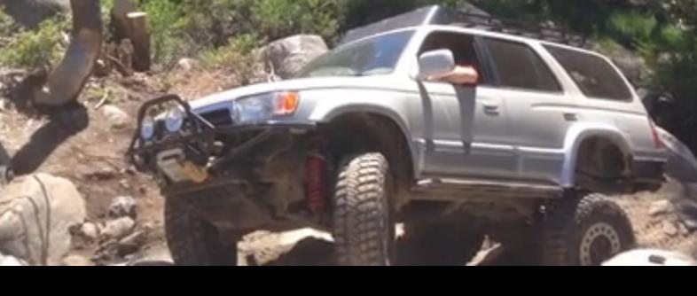

Let's see if this works.
This is the full length run up the steps.

Nice pics and videos Todd! Bummed I missed this one, but hopefully sometime this summer we can get out on a wheeling trip together.
BTW, how did Drew do? I haven't seen him on the forums at all. Any damage?
Todd your truck and driving skill continue to amaze me.
So when and where is the next trip?
Thanks a lot Mikey. I still have lots to learn, but its definitely been a wild journey the last year with this 4runner. :thumb:
Next trip may be in October as I have a ton of stuff going on with wedding planning through the end of August.
I will definitely update you on when it will be. :beer:
Drew did great. No damage what so ever. His runner had the clearance needed to get through the trail with some careful spotting.
