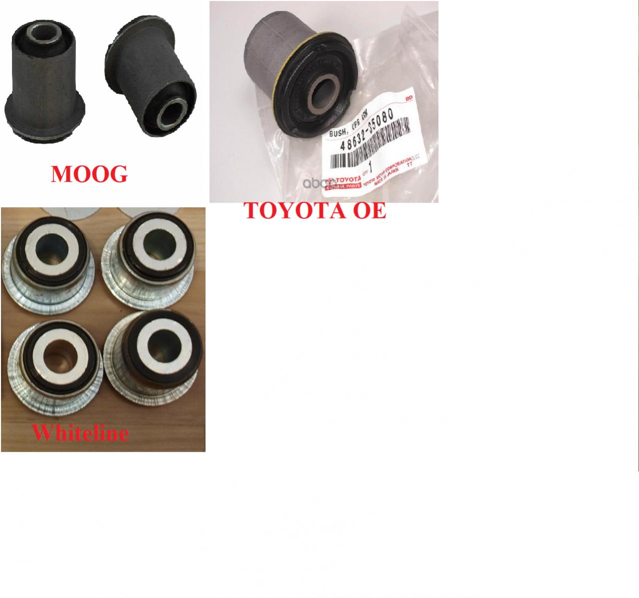

How have your whitelines been doing? I've always heard/had nothing but good things with them but it seems the LCA bushings are kinda hit and miss. JRoss even said he had to change them out after a mere few weeks cause they got trashed
They feel as solid as the day they were installed, so no issues for me. I would guess that the people who have problems either bought knockoff bushings or didn't install them correctly with the washers that are a PITA to get in. Possibly a lack of (OR mixing of different kinds of) grease could cause the exact same issues.
The Whitelines I have bought have tremendously exceeded the build quality of any other aftermarket bushing I've ever used.
Moog has consistently had the worst aftermarket parks I have ever used. I would give them a 1.5/10 because ONE single ball joint we put on a Jeep has lasted over a year. Every other part I have ever put on has been shot in less than a year of moderate driving. I hope that my experiences have all been random misproductions, but one out of ~20 parts is a decent pool to pull from.
Energy Suspension also makes some pretty good stuff, so I use them for the less critical bushings. The price is fairly lower on the bushing made by them, but they aren't majorly over-engineered like the Whitelines are.
Here are my experiences for the 3rd gen LCA bushings
-Factory Toyota were decently worn at 200k with no lift (completely destroyed with lift and 315k). They work great, but not perfectly solid as they are a thick rubber bushing.
-Energy Suspension didn't work because they don't come with the metal sleeves/washer (you will almost certainly destroy these)
-MOOG brand new had almost exactly the same play as the Toyota ones did at 200k. Completely worn out in a few months with 2-3k miles and 5 easy offroad trails. They are also very easy to damage while you're trying to press them into the LCA because of how poor the bushing material is.
-Whiteline blew me away with how much more stout they were than any other option. The ribbed poly bushing design was a great bonus to keep things lubed. They actually didn't require the press to fully install them into the LCA, so nice and easy there. The bad part to them is that the metal outer washers were hell to install with the LCA into the frame mounts.

I'll see if I can get a video showing the difference in flex between some 50% worn out OEM LCA bushings and the brand new Whiteline bushings.
I really wish I hadn't lost the video showing just how bad the flex was on those abused 317k bushings. It flexed a bit shy of 2 inches at the tire with an ear-bleeding symphony of squeal and crunch.
