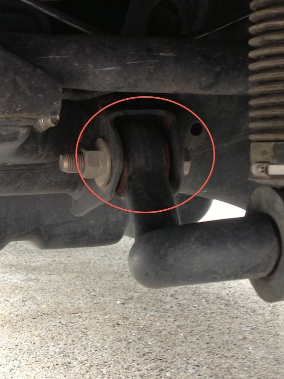

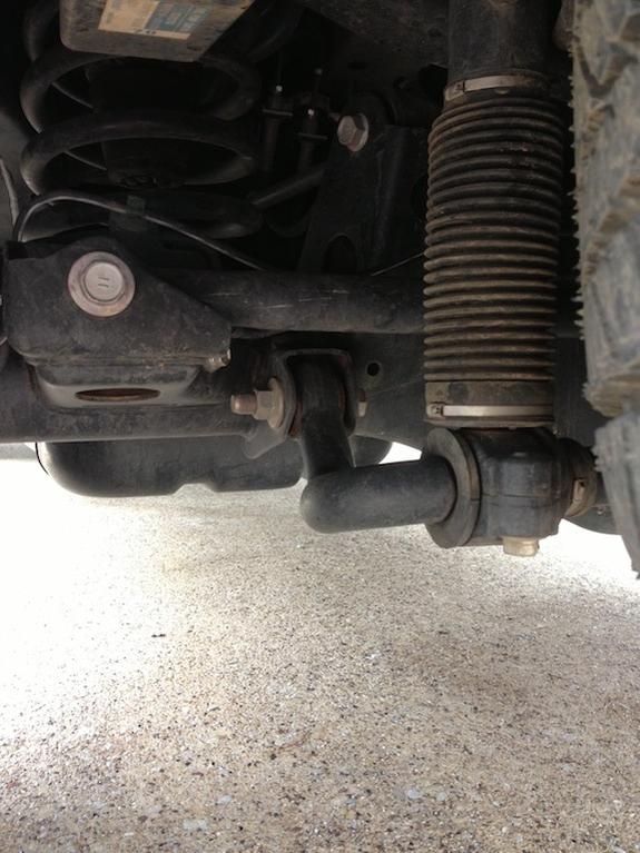

I just ruled out the spare tire and the rear hatch latch catch:doh:; they are non-creakers. The sound definitely comes from the rear of the vehicle on the driver's side.
I think its this guy:

and by "this guy" I mean this guy:

Is that the rear upper control arm? If so, sounds like what BigRedTex mentioned in his post and I guess I'm off in search of bushing lube. It was hard, but I fought the urge to just spray "Fabulous Blaster Garage Door Lube" all over the place. That stuff is awesome.

What you circled in the pic is your rear KDSS sway bar end link. That is a teflon lined bearing in there, while it is possible it could be the cuplrit, I would doubt it.
Since we are thread jacking here, is there any recommend maintenance on these teflon lined bearings? And would you know off the top of your head where else in our suspension Toyota uses these bearings from the factory?
