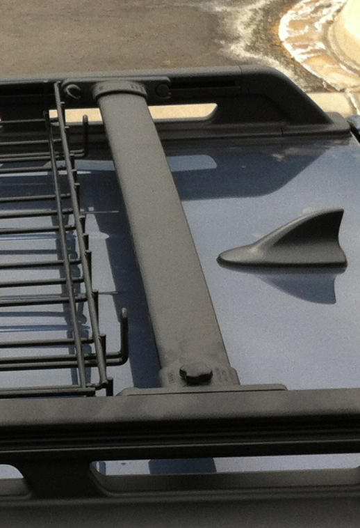

It's been a while since I've had the factory TE rails and crossbars on, but IIRC the side rails are slightly farther apart at the rear of the truck. I want to say that to get the longer crossbar on I had to move the mounting points on the side rails as far back as possible then attach the crossbar and slide it forward.
If you haven't figured it out yet, check the ends of the cross bars. I remember seeing either "front/back and arrow" markings on the ends of mine when loading my kayaks last weekend.
You're right, the TE side rails are not parallel. They're wider in the back. Hence, the crossbars came out at different lengths.
The crossbars are adjustable, via the knobs -- one on each crossbar.
Loosen the crossbar knobs, install the crossbars with the side rail nuts toward the front, then tighten everything up.
