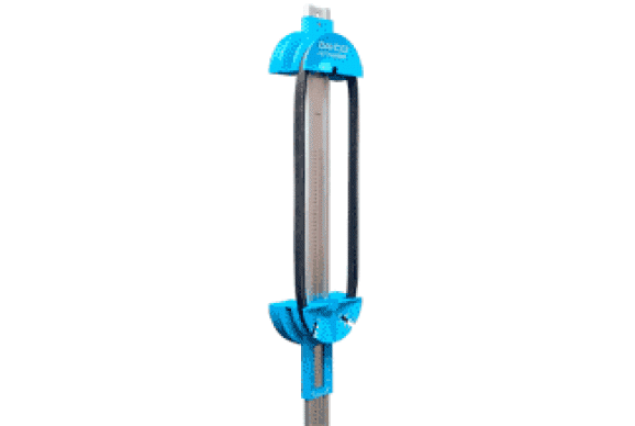

Fast forward to my new side job at Autozone. Whilst stocking belts in the back one day I ran across this wonderful device:
This big boy measures the belt down to the millimeter in a matter of seconds, which *CAN* be cross-referenced in the computer to find something of similar profile and length. I hope this helps someone else. I plan to resume my project soon now. :heh:
TL;DR - Go to the autoparts store and ask for a 2" longer belt. They actually can do it.
