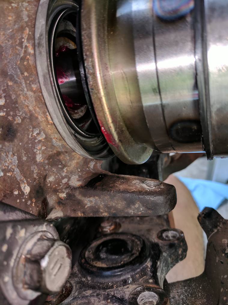

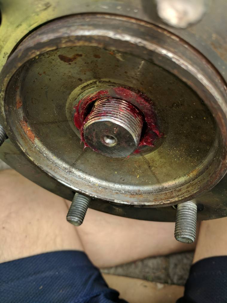

Hi y'all,
I'm trying to install a new cv axel on a 98 4x4. I am unable to get it to mate with the hub properly. Does anyone have any suggestions? Thanks in advance

From the pics it looks like he is having issues with both.
how'd you figured? i don't see the front diff in the pics..

If you look closely at the second picture one can see ball bearings at the top of the new axle threads for the axle hub nut. That is a real problem, and my guess is the problem will only be rectified with a new wheel bearing.
Good eye. I think the OP needs to see this video then. It's not the exact thing since the video is for a Manual Hub Conversion but the job is very similar for the standard knuckles that come on the 3rd Gens.

Thanks for all the suggestions. I was able to use the nut to pull it through the axel. I will look in to the wheel bearing.
I think those are globs of grease. That is the spacer inside of the ABS rotor and if a bearing got in there that bearing would be GONE. Besides I think the bearings are cylinder shaped.
Ignore everything I said - you age, your vision goes, your mind goes, and then you start blabbering about things that are not applicable (grabs for drool cup...)
