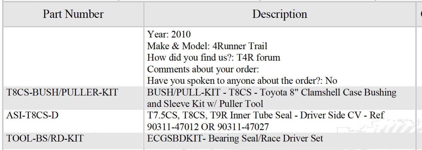

I know this is old, but I've been searching for info like this for months and I wanted to thank you! Did you (or anyone on here) get either of the tools ECGS offers for this? I'm debating whether to pay that much for tools that will only get used once.
I had to go back and look. I bought the kit with the puller tool and I bought the bearing seal/race driver set. I hate to get in the middle of a job like this and not have the right tool. I'm sure you could probably rent or borrow similar tools but it was worth it to me to not have to chase things down. These are tools that you can use in other situations though.
