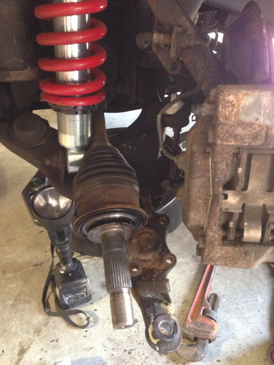

Got the napa cv axles with a lifetime warranty for 103.00 a piece. Got the tie rod ends on. That was super easy. Got the cv axle all ready to take out. Will try in the morning to pop it out.
Is there a easy way to pull the axles out of the differential?
Thanks
Ya just use a crow bar and get it wedged between the axle and where it enters the diff. Then just pop the crow bar with your hand and the axle should pop right out. One word of caution: when you pop it out try to have someone there holding the axle to pull it straight out. BE VERY CAREFUL as there is an oil seal right there where the axle enters the diff that has an easily tearable rubber ring on it. When I changed mine I was being careless and the seal got torn. I didn't notice it until it was all put back together and then it started slinging oil all over the bottom of my truck. Replaced the seal and no leaks since.
