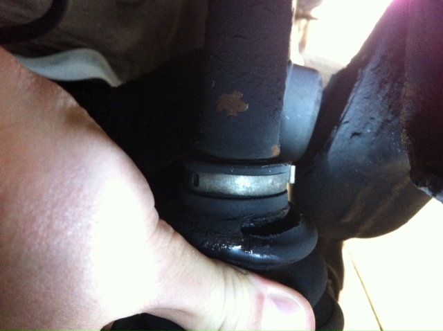

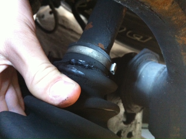

I know there are multiple threads on here and 120.com about this but I can't find the right one that has a bunch of people that have replaced their axles. Let me know if you've done this and what you've used. I'm just going to replace both axles when I put my lift on. At least I found this out before I did my lift so it can all be done at once. Post some threads about this if you know of any.
Check me out:

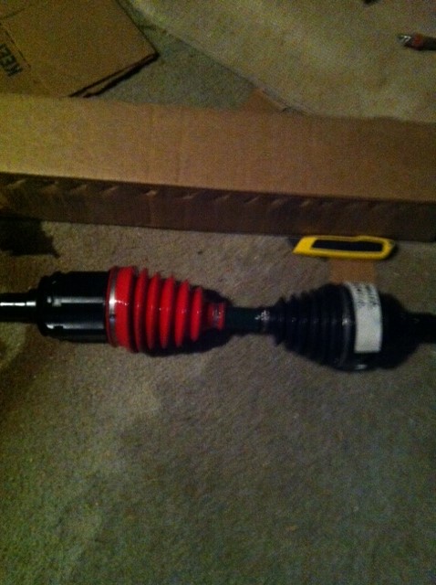

Just got the CVJ axles today, the boot is twice as long as stock and seems to be a better material. Looks sweet too I think.
