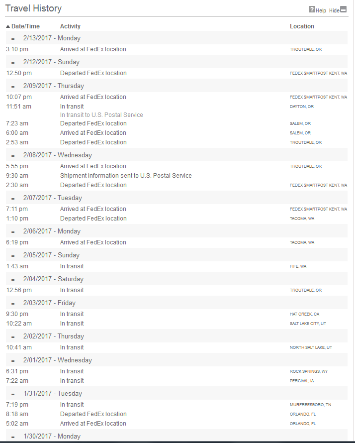

I'd also just like to say UPS "Mail Innovations" And Fedex "Smartpost" are the dumbest things ever to happen to shipping. They always end up taking longer and moving my packages more times. I've been delayed probably 2 weeks on my new UBJ's beacuse of Fedex smartpost. Look at the package tracking history. Stupid.

What?! Troutdale to Tacoma to Troutdale to Salem to Dayton??
That's just insane.
That's just insane.

I really don't get how it went from in transit to dayton from salem (Literally a 20 minute drive) to in Kent and then back to Troutdale. Fedex already sucks in my area, but these USPS handoff deals always end up like this for me, with both UPS and Fedex.
