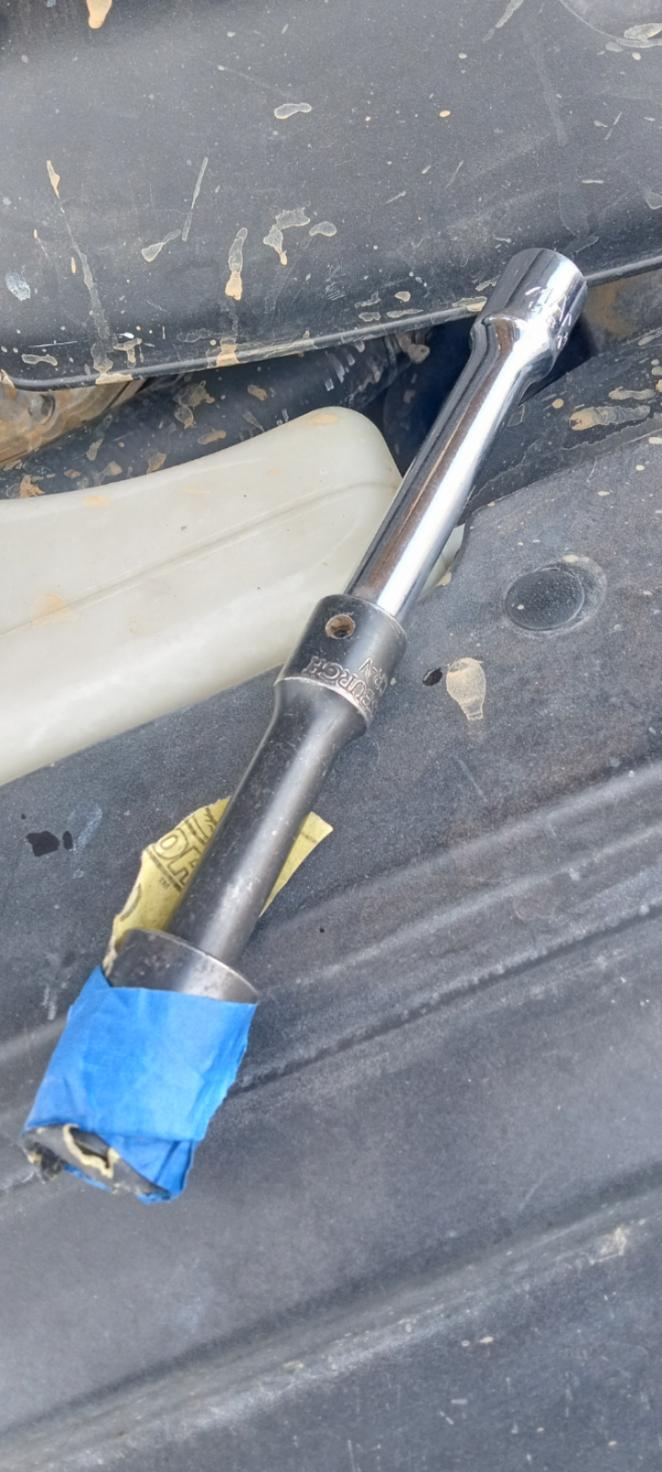

Found a spot where I can burp the radiator tomorrow.

Left the cap off all night on a slope and topped it off this morning and the bubbles are gone.
