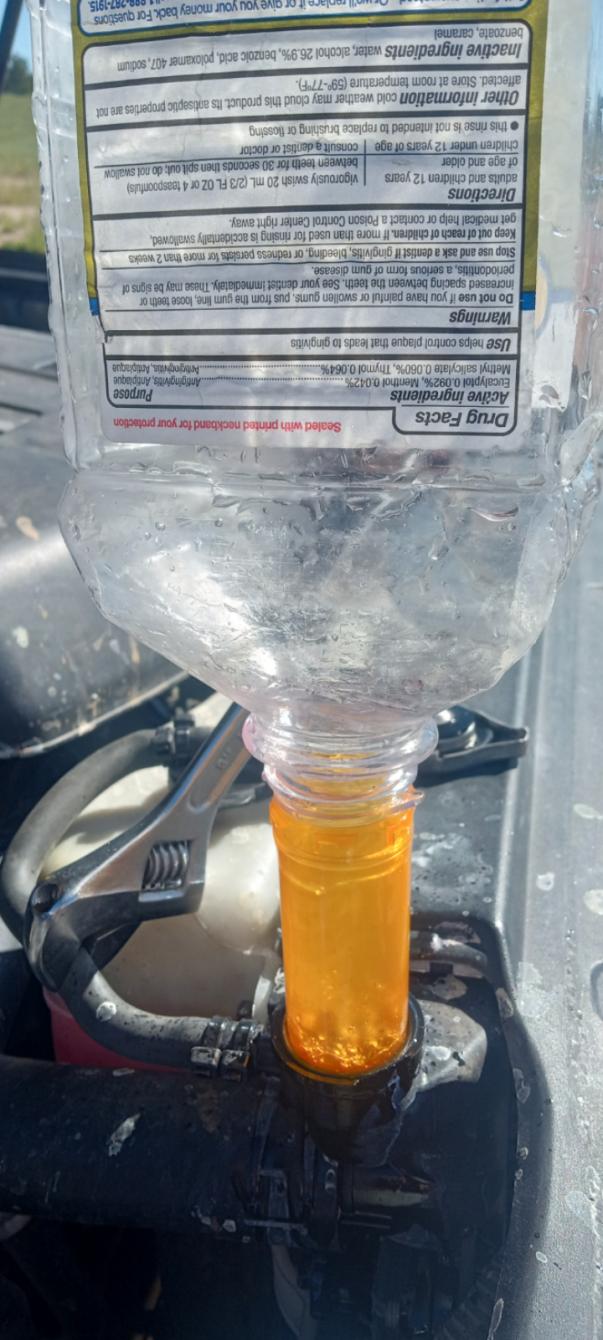

I also made this to bleed the system. Pill bottle plus Listerine bottle fits almost perfect. Push fit with just a dribble around the edge. Should have the new cap by this afternoon.

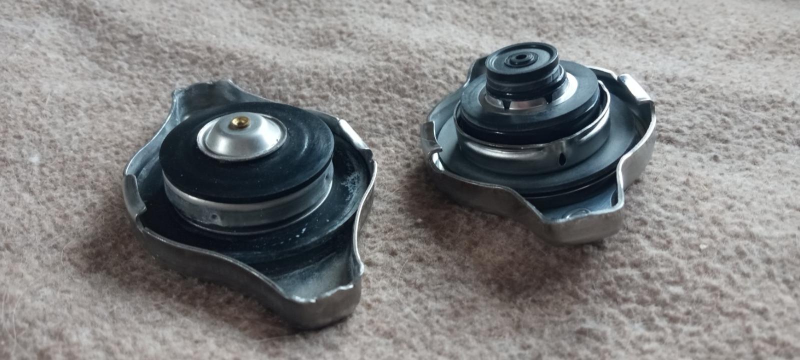

NAPA cap vs. oem..
Totally different design and if this doesn't fix it, who knows.
Looks to have an extra check valve that releases in the center to instantly pull back liquid from the reservoir upon cooldown. Has to be the issue. Will update after a couple days once I get it on there.

Three small trips with heat cycles and success.
  • Fluid doesn't fill the reservoir when driving.
  • Fluid gets pulled back in on cool down.
  • Waterfall is 99% gone, and I think with a few more cycles with the proper cap now will be gone soon
So if you are using a generic cap, you may want to switch to OEM before you do anything more than around town driving.
Sometimes genuine Toyota is the only thing that will work. You seem to be on the path to happiness. :)

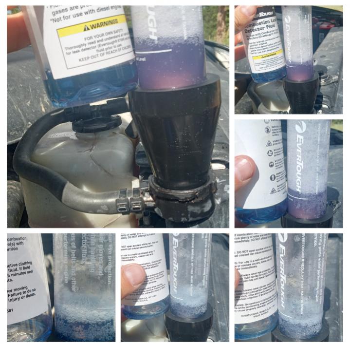

The combustion test kit with fluid is a rental at O'Reilly. I also added new smaller diameter hoses to the overflow and the siphon.
Here are images from 2 tests over the course of 5 minutes. Doesn't look like it changed at all, which is consistent with the pressure test holding 15psi 3 times.
I'm going bonkers here.
