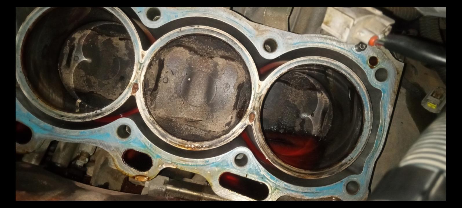

Well I'm kinda happy that there's this much water in the cylinder after taking it all apart.
Despite the tests showing no problem, the radiator pressure indicated there was.

Just stumbled onto this thread. That's a lot of coolant in cylinder #6.

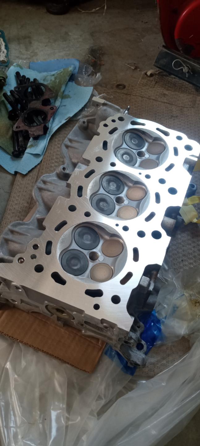

Did you check the heads for any warpage when you did the head gaskets the first time?
Did not last time. Was being cheap. I thought the 2005 just had a gasket issue, not a warpage issue.

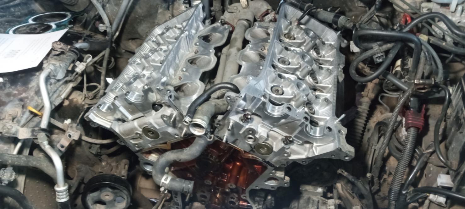

It's all back together.
A few hand tools and the specialty crank remover tool.
OEM valve grind set $275
Head machining/cleaning/testing $280
Head bolts $95
New serpentine belt $30
Toyota fpig $20
2 gal coolant $40
Timing guides $50
Gloves/cleaner $30
Total just over $800 to save more than $5k and get another 5 or 6 years of stress free driving from hopefully
Congratulations! Having done this job myself, I respect anyone willing to take this on. Not only once, but twice.
