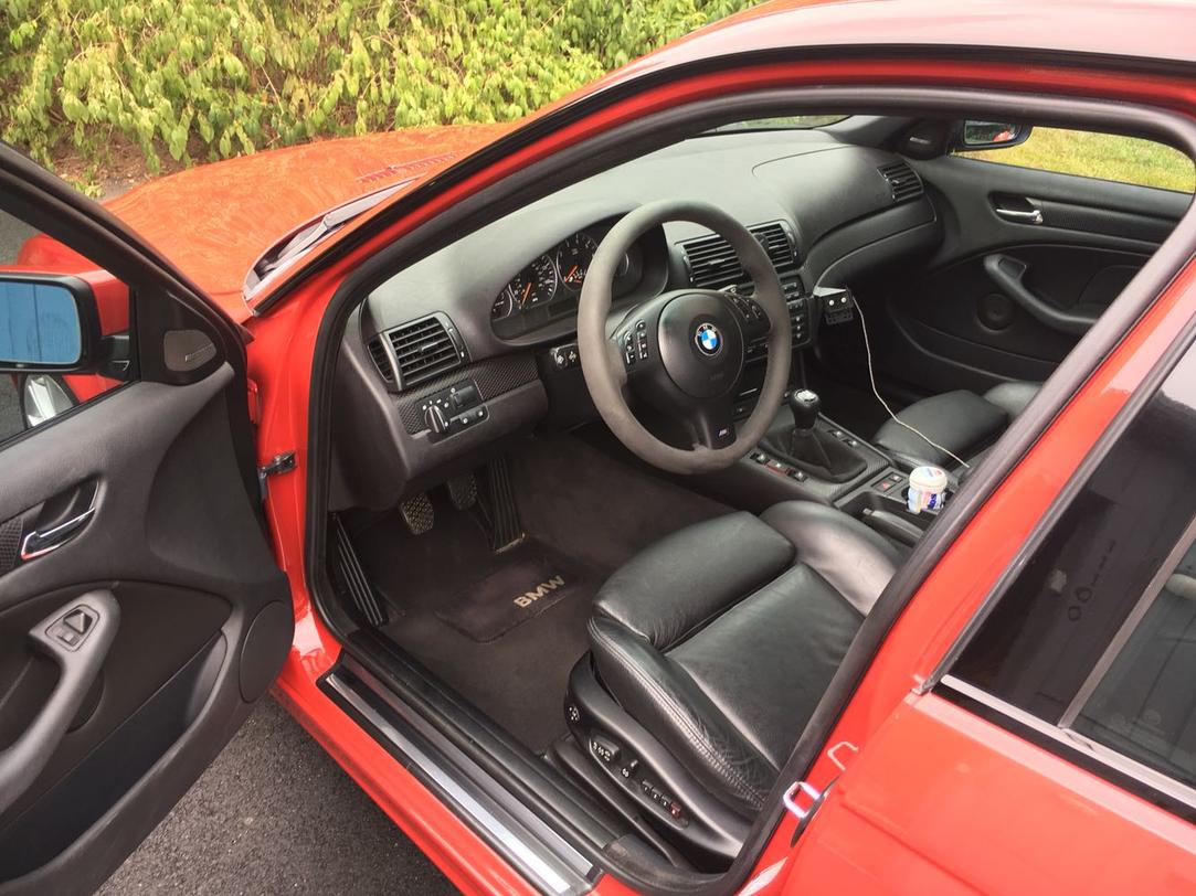

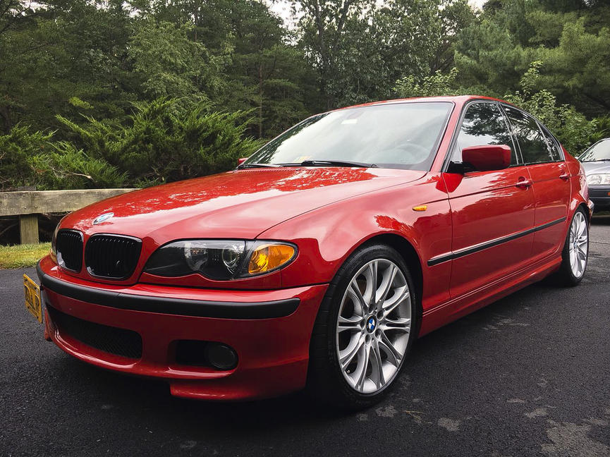

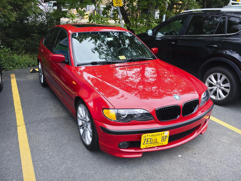

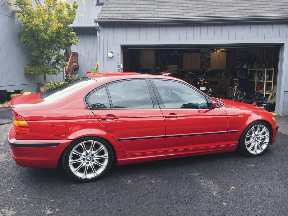

Really really nice build/resto! I like that you are keeping it mostly stock. These trucks are incredibly reliable without serious modding.
On a side note, I'm really digging that e46!
Hell yeah. I'm pretty much all about OEM+ with both my cars. That E46 got a limited slip and coilovers kept at virtually stock height. This truck will be similar. I'm keeping an eye on Absalom's Cookie Cutter builds. Somewhere between Weekend Warrior Pavement/Trail. 99 talls...E-locker retrofit...something like that. :rockon:
Thanks man! My other boo... :car:
Have you done any exhaust work on it? Those 330s sound nasty with an eisenmann exhaust on them!
https://m.youtube.com/watch?v=4d-qVQTp7C4
