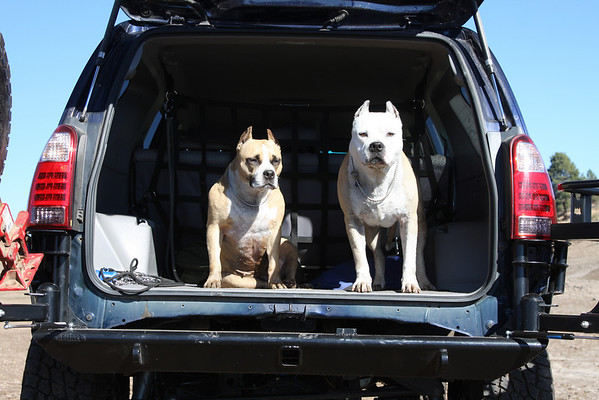

As for the net, it's the net for the FJ Cruiser. Basically mounts to the D-rings on the floor. For the top mount, you need to buy two more D-rings (or relocate the other two mounted in the cargo area) and mount them where the coat hangers mount. The coat hangers are mounted with (2) 10mm bolts which attach to the body for a solid connection. You'll have to trim a little of the plastic coat hanger to get the d-rings to fit nicely, but not a huge deal.

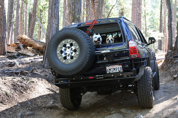

one question though: I really dig the rear mounted spare, an have been looking at bumper and bumper attachments to mount the spare. Where did you find your bumper? It looks has the hinge to swing the wheel to the driver side, good feature.

Thanks, the bumper is pseudo custom by 4x4labs in Grass Valley, CA, largely known in the Landcruiser crowd. I say pseudo because they're made to order and he needs your rig to build it. Cutting the rear crossmember off is a requirement to fit this bumper too.
Look into CBI rear bumper for a less extreme modification.

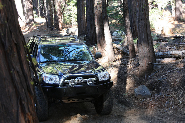

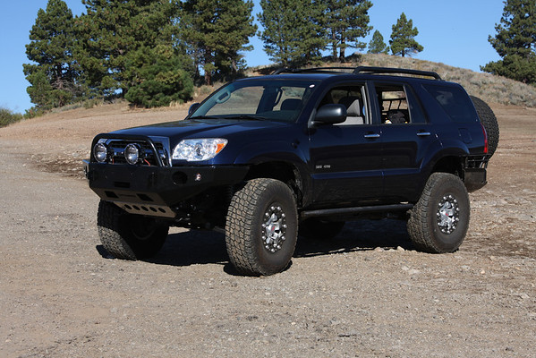

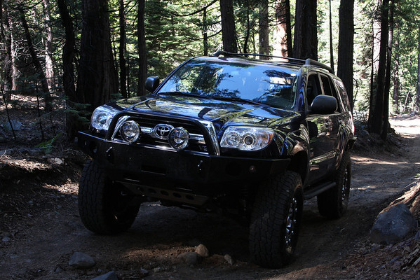

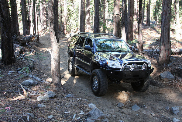

So I finally got the SW bumper after about 6 months of waiting. Still waiting on the PIAA fogs to come in, but here are some pics from this last weekend up in Tahoe. Did some exploring with the dogs over at Stampede Resevoir and also got in a quick run over at Eagle Lakes on the way home.

A couple poser shots from Eagle Lakes
Looks good! The picture of your dogs just peeking over the tailgate is awesome. Bumper looks great. Makes me want a bumper, just have to wait what the SW and Demello final bumpers look like. I'm hoping for a single hoop version too.

Thanks man. Based on my experience with Shrockworks, I'd say spend your money with Demello. Shrockworks are not bad people, but the wait time is rediculous.

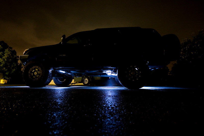

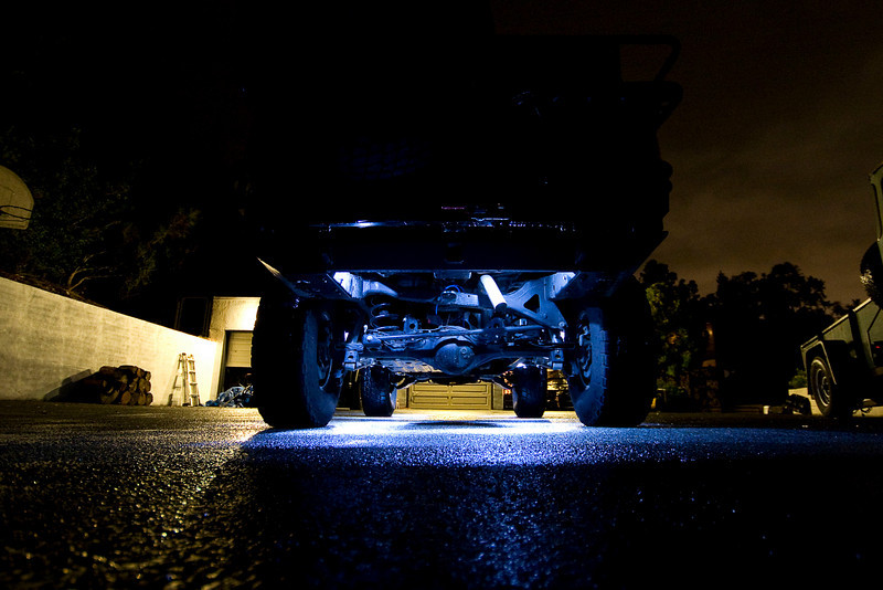

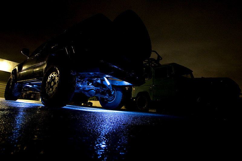

Me and my buddy hooked up the VisionX Tantrum LED rock lights the other night. I fried the controller box when it was hooked up on my FJ, so I bypassed the controller box and wired them to the runner. I lost the blinking light functions, but those were stupid anyway and never used it. So now it's an on-off switch instead of a remote control.
