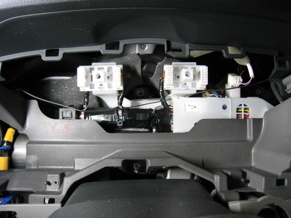

Just wondering if anyone knows which of the four connectors has feed from the dimmer for the backlights:
The radio/AC stack lights work fine and the dimmer works with those. I am guessing it is something on the circuit board...a cold solder, bad resistor, capacitor etc....but who knows

thats looks strange, check the dimmer wire on the radio too, and see what happens when you unhook the orange wire.
