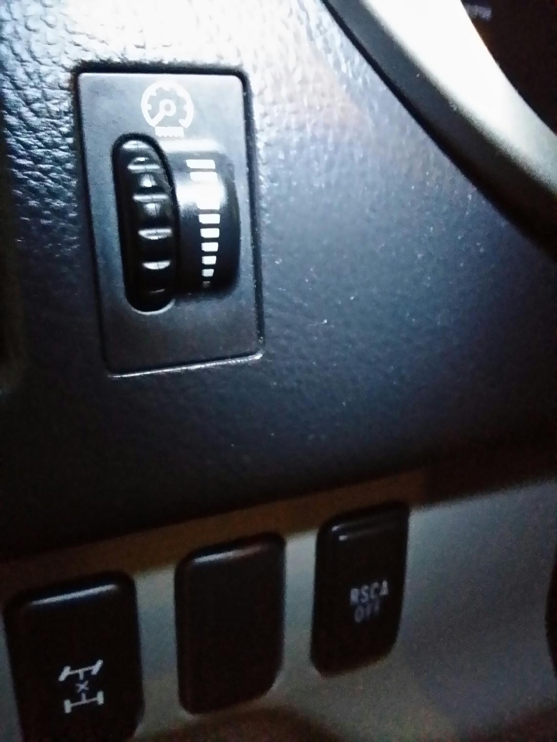

Its all from the dimmer switch. Mine went out and I had the exact same thing happen. I could not locate one outside of the dealer so I was able to jump pins on the back to get the the lights to come back on. I no longer have control of the brightness, but theyre on so it works for me. I also had some bulbs go out, which are very easy to replace in the ac unit. You can pick them up at radioshack. I dont remember the part number, but someone here should be able to chime in.

So I just went to my garage and took a quick picture of the Dimmer Wheel/switch. this is what mine looks like which yours should be the same since we have the same rig.
